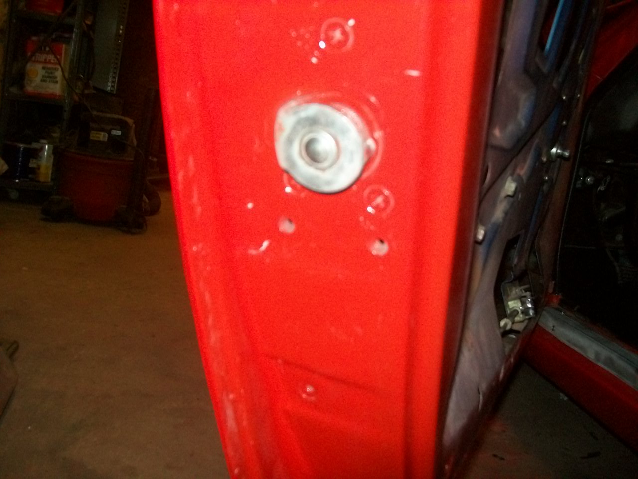

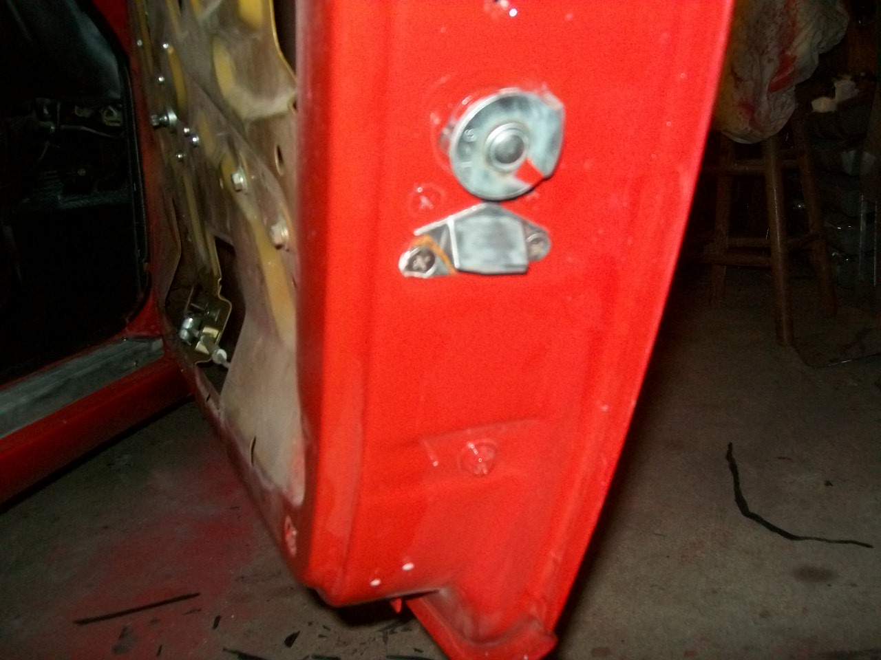

Hey Steve.... Here are the pictures..... notice the one side (passenger) has the latching device and then below it is the "guide" and on the driver's side, there is the latching device but below it, no "guide"..... When I bought the car, it was a project car that the owner decided was going to take too long to work on... Every single thing that was missing or removed from the car was a problem... and it continued this morning too... anyway.... can you help me with the name of the part I need so I can at least look around on Ebay for one? Thanks... I really appreciate the help!! Dennis

Dove tail
80530-N4500
Motorsport! Door Dove Tail, 70-76 240Z-260Z-280Z - The Z Store! Nissan-Datsun 240Z-260Z-280Z-280ZX-300ZX(Z31/Z32)-350Z-370Z Parts
NissanParts.cc - Your #1 Source for OEM Parts and Accessories
DOVETAIL - :: Nissan Parts, NISMO and Nissan Accessories - Courtesyparts.com
