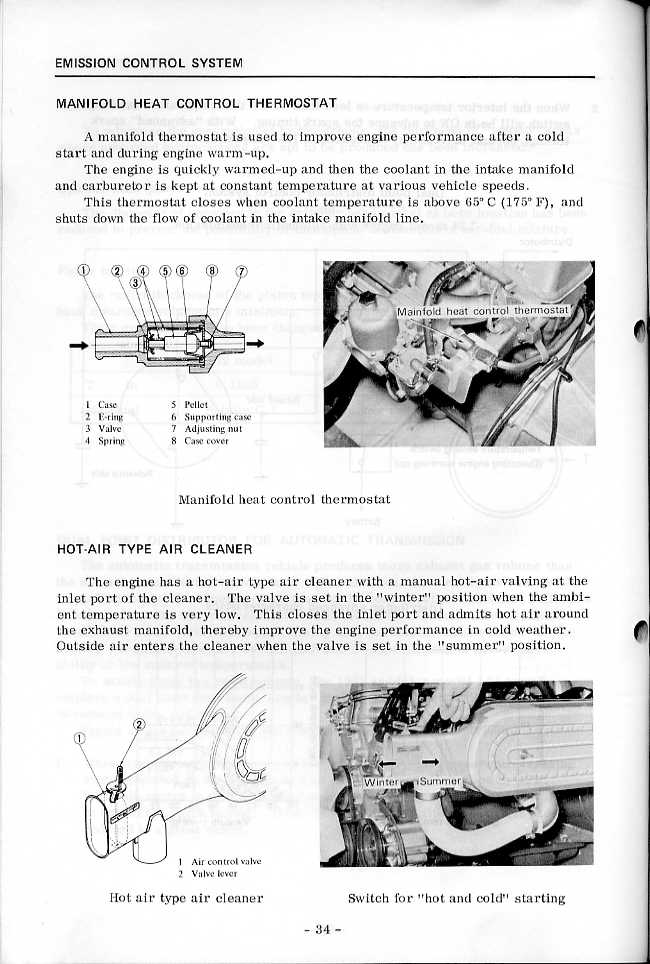

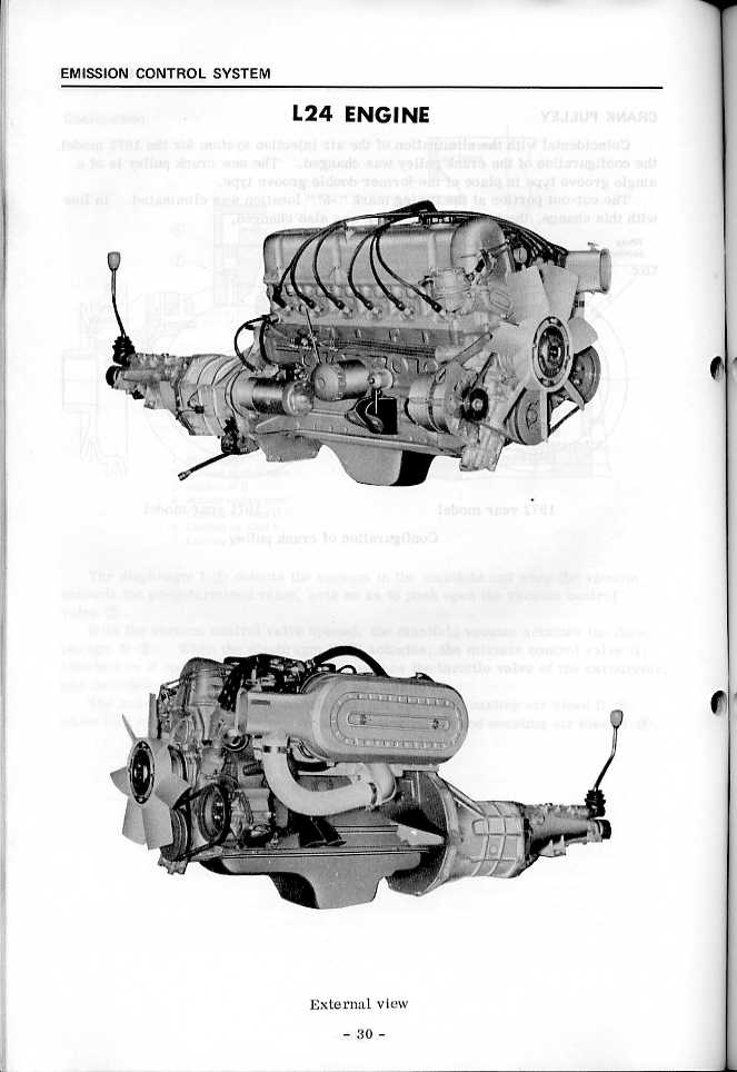

Sevice Bulletin Vol 142
This is for the 72, but should be close to yours

Hey Mike... your research is better than mine and you found the answer I was looking for.... I now understand the thinking behind the flap, and yes, there is a duct from the exhaust manifold that enters between the flapper and the filter main body.... so when the flapper is closed, the engine heat exhaust is reintroduced into the carbs.... warmer air after a period of time than the outside air... There was a lot of discussion from the people who wrote in, that they lived in California and would not need this option. My car will not be driven in the winter here in Minnesota... so now that I have a little understanding, I am going to take a look at the spring loaded flapper and see if there is a way to lock it in the open position, from the manufacturer.... if not, I will find a way to keep it in the open position...... Thanks for your help and the supplements.... the one showing the exhaust duct is identical to what my air cleaner looks like... Dennis PS... The duct from the exhaust manifold to the air cleaner, is half gone....
