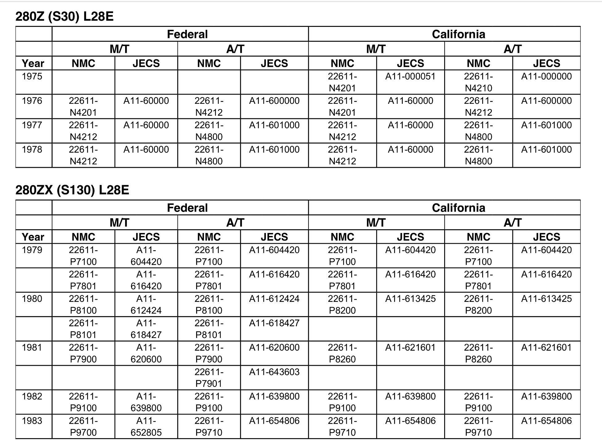

Look for an ECU locally first. Here is a list of ECU numbers. your best bet is to find the exact match to the one your car had from the factory but in a pinch any 79-81 will work.

According to the list you should have an A11-612-424 or an A11-618-427. Check which one you have and post it here.

Thank you for your help and I have no doubt that you are genuine, your knowledge is excellent. I have an ECU A11-600000 with chassis number HGS130- 130... Apparently, my ECU is from an earlier model S30. (Thank you for your chart). I am not sure if that makes a big difference, but I now have a reference point. I am sure this car has not run for years and been passed on to multiple owners trying to fix the problem and each one leaving a multitude of other problems. Parts for this car all have to come from the US and that takes weeks, and the exchange rate makes everything expensive. I have a Cardone ECU 72-3112, but it is a later model with the o2 light. I have not tried it. My question is. Do I just swap out the whole system for a 260 Z manifold and carburetors to get the car on the road.

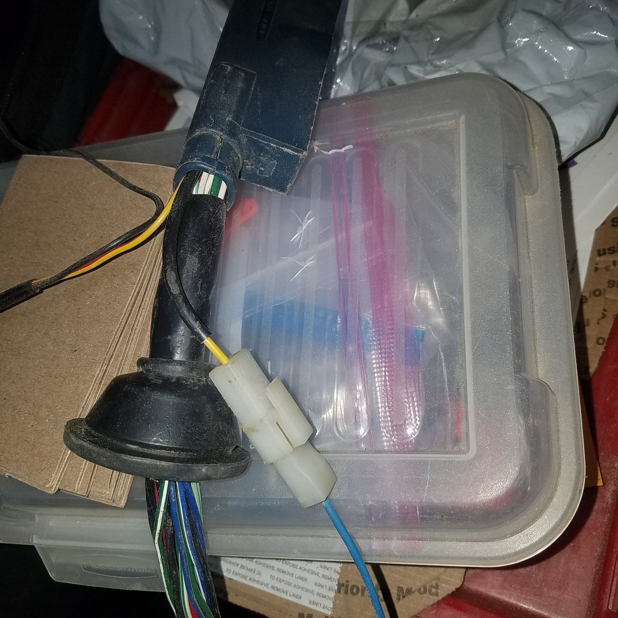

The way your injectors work is the ECU counts how many times the ignition coil fires. Every third time the coil fires the ECU grounds all of the injectors at the same time.This is galled gang fire. So check your ignition coil. The blue wire on your ignition coil splits into 2 wires inside the wire harness. One goes to the ICM (ignition control module) and the other goes to the ECU. At the ECU you will find a single wire that is outside of the wire harness. It will have a blue wire on one side of the connector and a yellow wire on the other side of the connector. That is the signal wire from the coil to the ECU. Check to make sure it is a good connection by following the test instructions in the FSM (Factory Service Manual).
