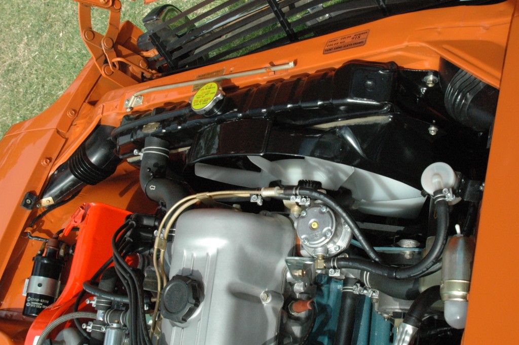

I had a mechanic working on my car and i got totally ****ed, he removed and lost the front fuel pump and also my keys, so i need to replace them. I bought a new mechanical fuel pump but i never actually saw it installed, so i dont know how to put it on. There is this large black lever thing that blocks it from being mounted the way it looks like it should be, does anyone have any photoes of a 240z engine with the mechanical fuel pump that i can look at to see how it goes. Also, how do i remove the lock cylninder to see if it has 6 or 7 tumblers so i know which part to buy for replacement. Any help would be appreciated.

I found this picture I took of a 1970 240z engine compartment. I hope it helps. My service manual says to install the fuel pump by screwing the three mounting bolts to the block. The big black lever thing should be the rocker arm/link assembly. You won't see it when properly installed.

The fuel pump had a 1/4" spacer installed with it... DO NOT DO NOT DO NOT... install the new fuel pump without a spacer... good luck finding a spacer...

You can get rid of the mechanical pump altogether and install an electric pump in the rear near the tank... MSA and others sell block off plates for the mechanical pump... fuel pressure should be 2.5-3 PSI....
