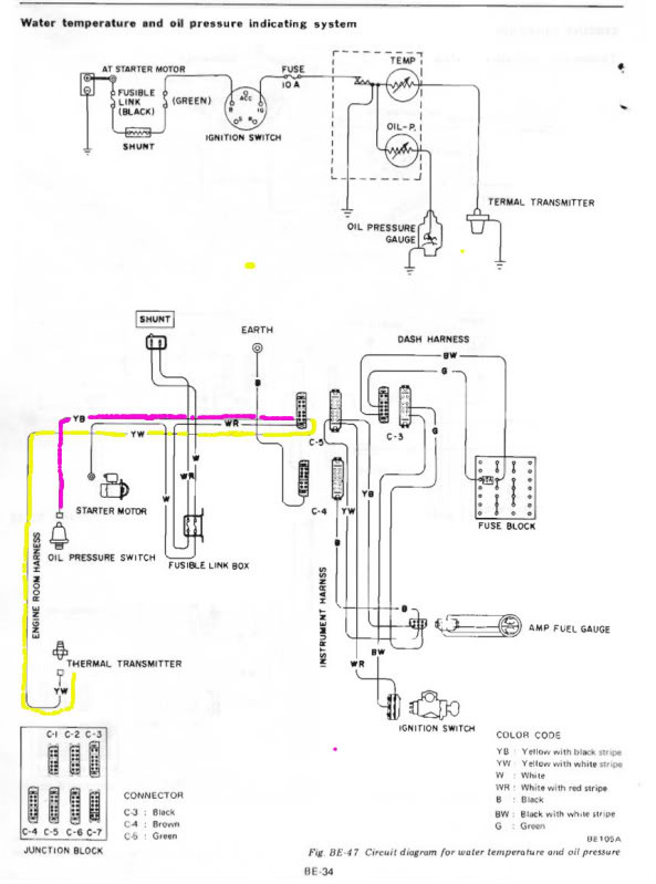

Okay, i just can't seem to find the resistor it must be really buried in the dash!!
So can i just splice my thermotime and oil pressure wire like so?

The temp wire on the thermostat housing goes to the dash harness as it was oem. The thermotime switch goes to the ECU. The thermotime switch turns on the cold start valve. If you don't hook it up to the ECU it will assume the engine is stone cold and act accordingly. The tach reads off the + side of the coil and is inline with the transistor ignition box on the right kick panel. The tach resistor is on the same wire. I think it's the blue one.

okay found the resistor just gonna run a wire from the neg to the resistor it was so far under my dash!!
Is it okay if I just splice open the white wire the water temp sw and run that to the C5 connector?
