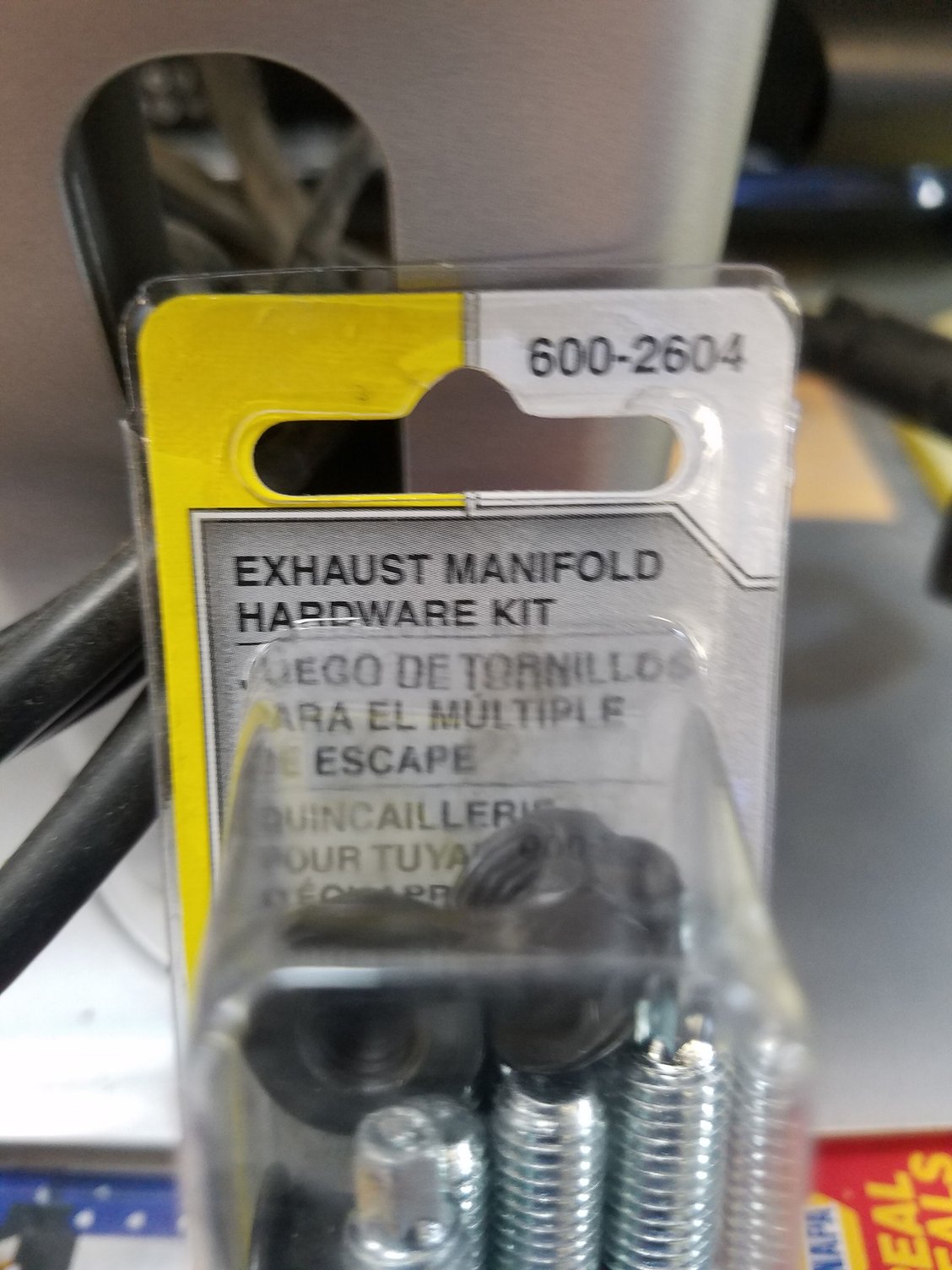

I picked up a set of exhaust studs and nuts from Napa auto. They were on the shelf and just a little longer on both ends and that is what you need especially on the exhaust manifold ends. They are the ones that break or come out. You can order the super heavy thick cast washers from Nissanpartsdeals.com
Hi temp exhaust nuts 08911-1082A 11 of these (come with the stud set from Napa if yo go that way)

I will swing by Napa and get the part number for the exhaust stud set they carry.

Here is the exhaust stud set that I used on the rebuild of my 1981. It is from Napa.

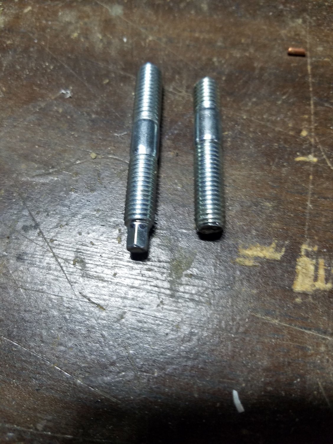

Side by Side comparison. Napa stud on the left, stock Nissan stud on the right. The extra length on the "short" threaded side will help retain the stud. They fit without modification.

Use locktite thread locker on the ends that go in the head. Use anti-sieze on the nuts. Run a tap into the holes to clean out the threads. This will make your life much better if you ever have to take it apart again.
