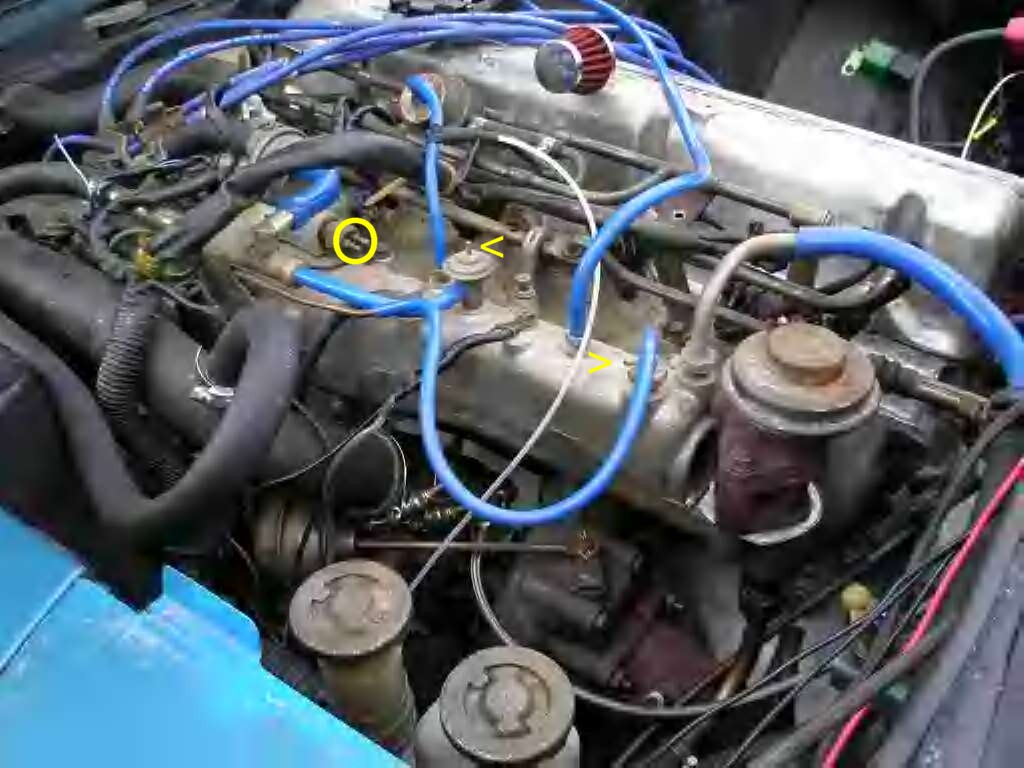

A source of vacuum leak is shown. A 1/8 hose connects the two fittings (arrows). Circled is a temp sensor but I don't think you have a turbo intake right? You also need a one way check valve on the brake booster. I am going to wait and use a megasquirt cause all those old sensors are at best weak.

its an NA intake unfortunatly, hmmm, dint know about the one way ont eh brake booster, i'm going to try to find an EGR less mani with teh air regulator blocked off. still would need a one way check valve though? thats for when its like under boost correcto?
