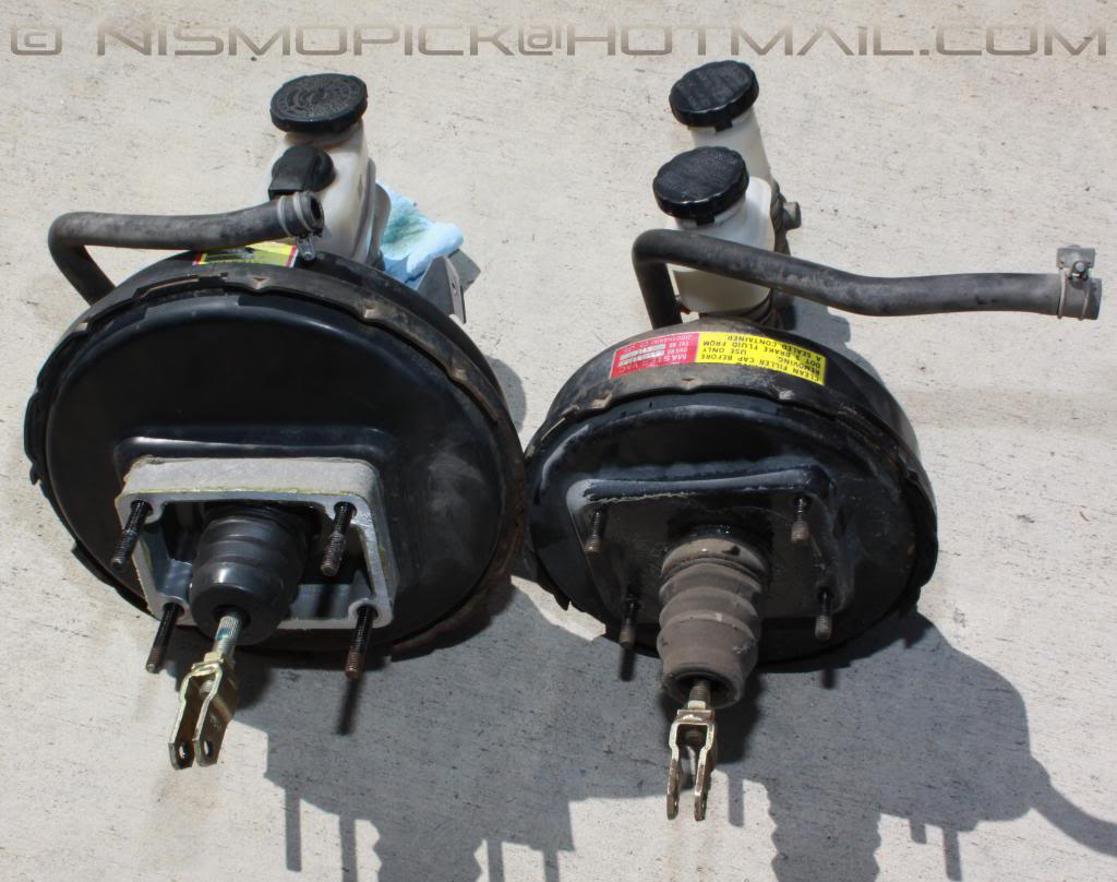

There's a pin that links the pedal arm to the plunger hook. IIRC there's also a cotter pin to pull first. Now that I think about it, I imagine the plunger can rotate in place, so once you loosen the lock nut, spin the plunger till it's tight & check again. Here are two pics of the booster (From my swap thread)... same basic items:

Thanks for the info.
I may have to upgrade to the 280ZX brake master at some point.
