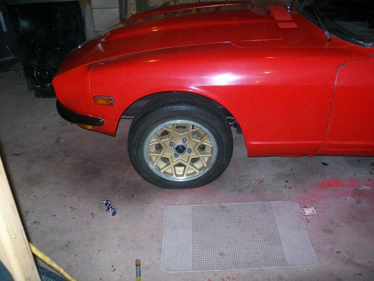

Hi... bought four NISSAN aftermarket rims and have restored them, but now need the correct lug nuts for them... contacted NISSAN and an "expert" wheel outfit and both asked for more information.... this morning they got the numbers off the back of these rims... they have NISSAN and 40300 stamped on the front of them... on the back is the code HT7U and the numbers circled 81 and 7.... also there is a 7A........ Can anybody identify what these rims may be, generation, who sold them, or better yet, a website that interprets code numbers like this? Thanks

I was just informed from the "Wheel Talk" people that the numbers I found were not OEM numbers.... so this is still baffling... The gold rims and the primered rims are the same... we tried a gold snowflake on the car out of curiosity more than anything else. Mags were on but are not correct for this car and causes a lot of grief.... wheel well rub to be exact... They were held on by 12mm 1.25 one inch long shanks with washers.... The snowflake rims that we tried (primer) have a half inch shank depth and I had some 12mm 1.25 quarter in short mag lug nuts that we used to hold the snowflakes on.... And I am not sure, but the short mag lugnuts fit snug inside the mags.... these same lugnuts do NOT fit snug inside the snowflake rims... there is quite a but of room between the shank and the inside of the rim lugnut opening... if that makes sense....
So, I was thinking on this problem a bit and is there a wider diameter shank?
Any help... suggestions are appreciated.... PS... Wheel Talk wants a couple pictures of the back of one rim and that is next on the agenda....
Thanks

Those are stock 15" snowflakes from the 1981 280ZX Turbo, so you'd use the 280ZX lugs:
280zx lug nuts - are they THAT special? - Wheels and Tires - Ratsun Forums
Thread is m12x1.25
Cheapest place would be your local junk yard. Second cheapest, ebay, then your local parts store, then Nissan (maybe not in that order )

Perfect
Hey!!! Thanks... perfect answer and I found it yesterday as well when I kept doing my research....
Chrome Factory OEM Nissan Infiniti Style Wheel Lug Nuts M12x1 25 Qty 20" | eBay
And the guy out in CA who was an "expert" helped me the most with his reply, other than this post which is ten times better. He told me what they had to be, and then gave me the link to his order form.... He want $100 for 16 lugnuts for my car.... I then went to Ebay and there they were.... One thing I do need to do, is to go out and do some measuring just to satisfy my curiosity that these are correct....
What I find truly amazing is that the parts man from NISSAN here locally had no clue as to what the rims were... and refused to help unless he got a stock number....
I will do some measuring to confirm all this and then go to Ebay and order a set later today...
I really appreciate the help....

Painted the rims today when I got home from work.... three coats of Rustoleum hammered gold.... found out that the paint color doesn't exactly match the cap, but I can live with them.....
