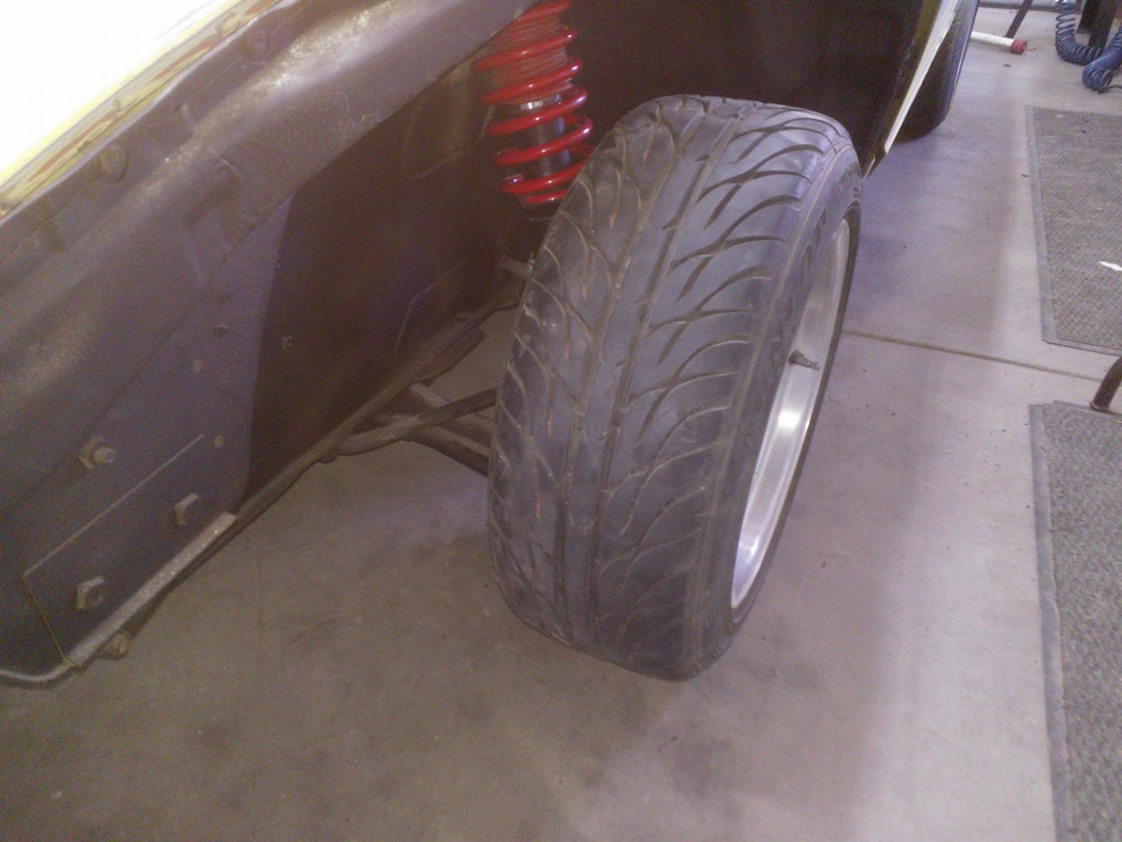

I put the Z down on the ground and didn't think it was quite low enough. I remembered back to when I got the Tokicos and realized they were for a 280z. Doh! I got some Vogtlands on ebay and sure enough they lowered it another 1 1/4 inches! I haven't test driven it yet but I now have about 3" of ground clearance. I also noticed that these load the suspension a little unlike the shorter Tokicos which "Bang" when you go over a large bump.
