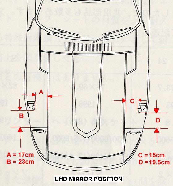

Hello im just starting my first 240z and im wondering if any one that has put fender mirrors on this car i would like to know the exact measurements of where to put the mirrors
