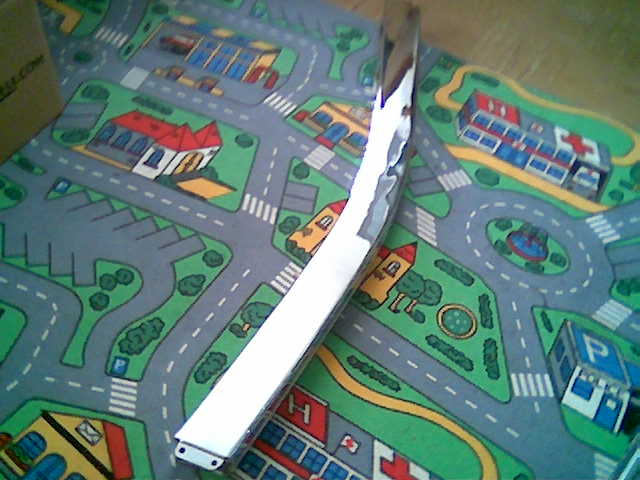

Alright, pictures of chrome are a little difficult, and this is the first photo I've taken with this phone, and I think the first one I've posted in a thread, so let's see if this works...
Old Aug 31, 2006 | 10:12 AM
Oh snap! I'd lick that
