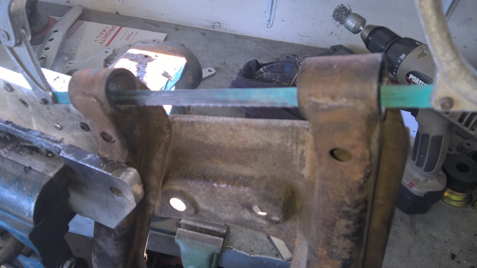

The best way to get the old bushings out is to burn them to death. The inner sleeve on the A arms needs to be cut through so it can be punched out.
Attached Thumbnails Body work-bushing-removal3.jpg   Body work-bushing-removal2.jpg   Body work-bushing-removal1.jpg

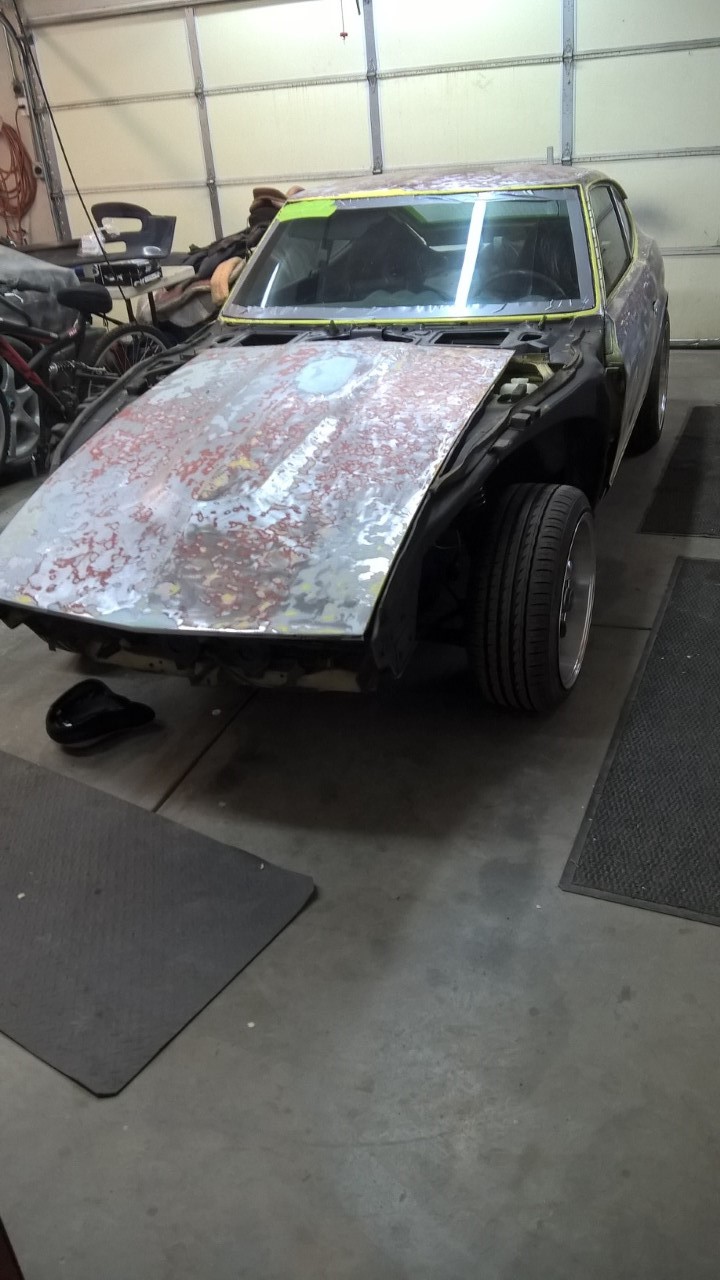

So while the bad girl was outside, (yes Scott,Skully, the metal one) I started removing all the old paint. Cut the glass molding back and taped the glass to protect from the sander. Plan is to have flush molding for a sleeker look. I'll leave it in place to keep the dust out. Back inside in time for 1/4" of rain today.
Attached Thumbnails Body work-sanding1.jpg   Body work-sanding2.jpg   Body work-sanding3.jpg

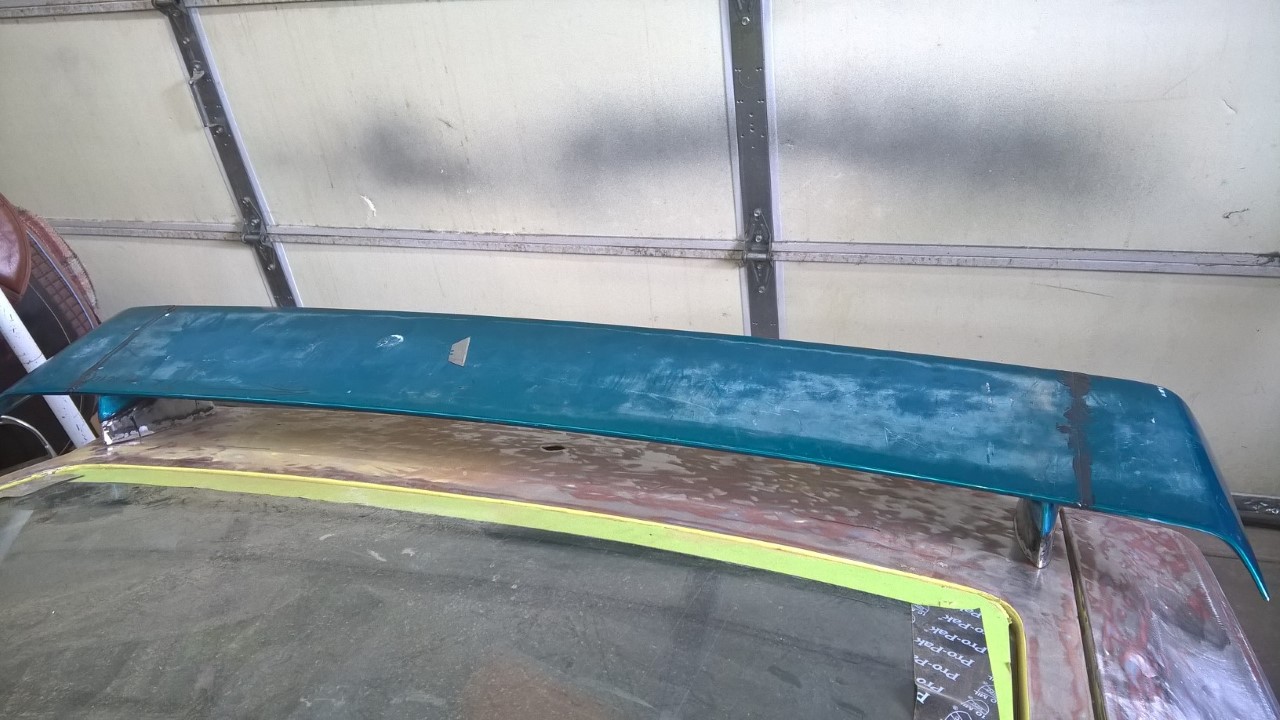

This spoiler is off a 90's Firebird. Going to shorten it by 8" and make brackets. The contour is perfect shape for what I want.
This car is going to be awesome.

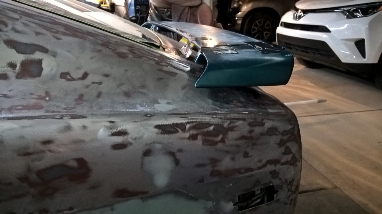

Spoiler mock up. Now for the brackets. Then carbon fiber wrap.
Attached Thumbnails Body work-spoiler-2.jpg   Body work-spoiler-3.jpg   Body work-spoiler-4.jpg   Body work-spoiler-5.jpg

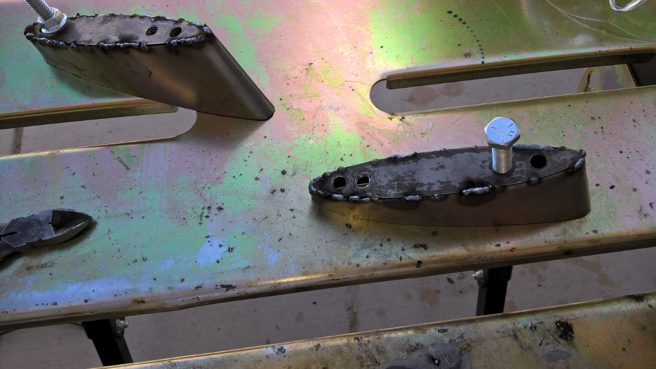

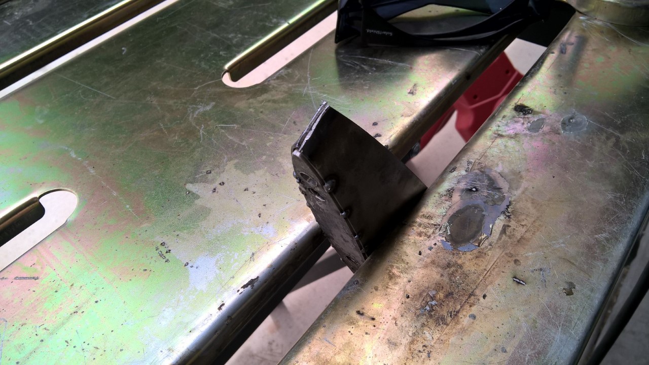

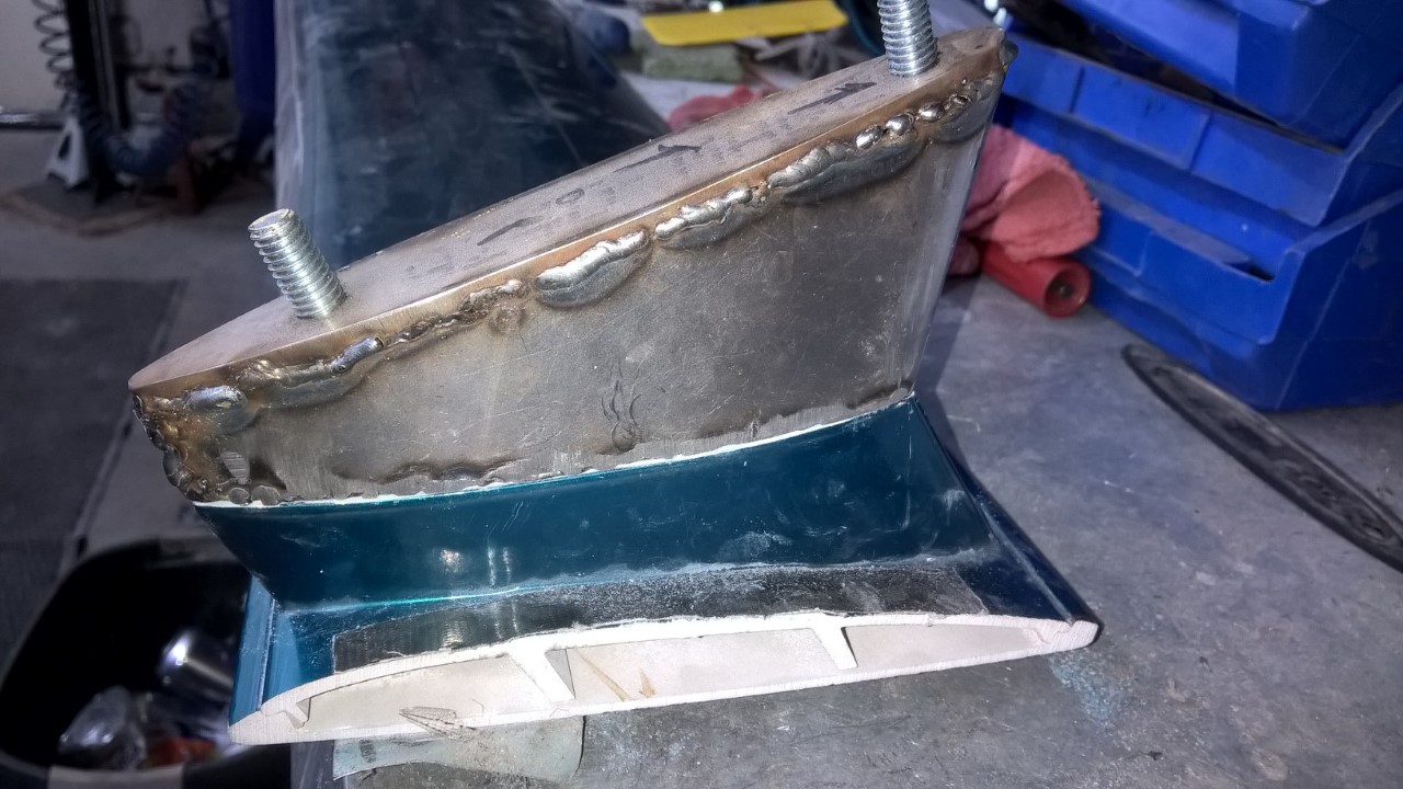

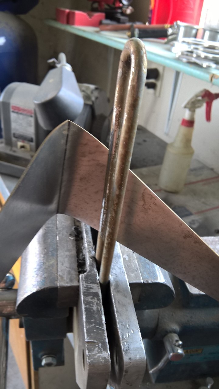

Back at it. Some real fab work. Had the skins cut on the water jet. Made the top and bottom brackets out of 3/16 stainless. Had to wrap the sheet metal around them. Started with the radius and gradually welded around the bracket just tacking it in place. tacked in the other one and stitched it up. Took them to work and smoothed out the welds. Got some panel weld adhesive to glue everything down and bolt on the car to test fit. Ordered some carbon fiber wrap.
Attached Thumbnails Body work-wing-1.jpg   Body work-wing-2.jpg   Body work-wing-3.jpg   Body work-wing-4.jpg   Body work-wing-5.jpg
