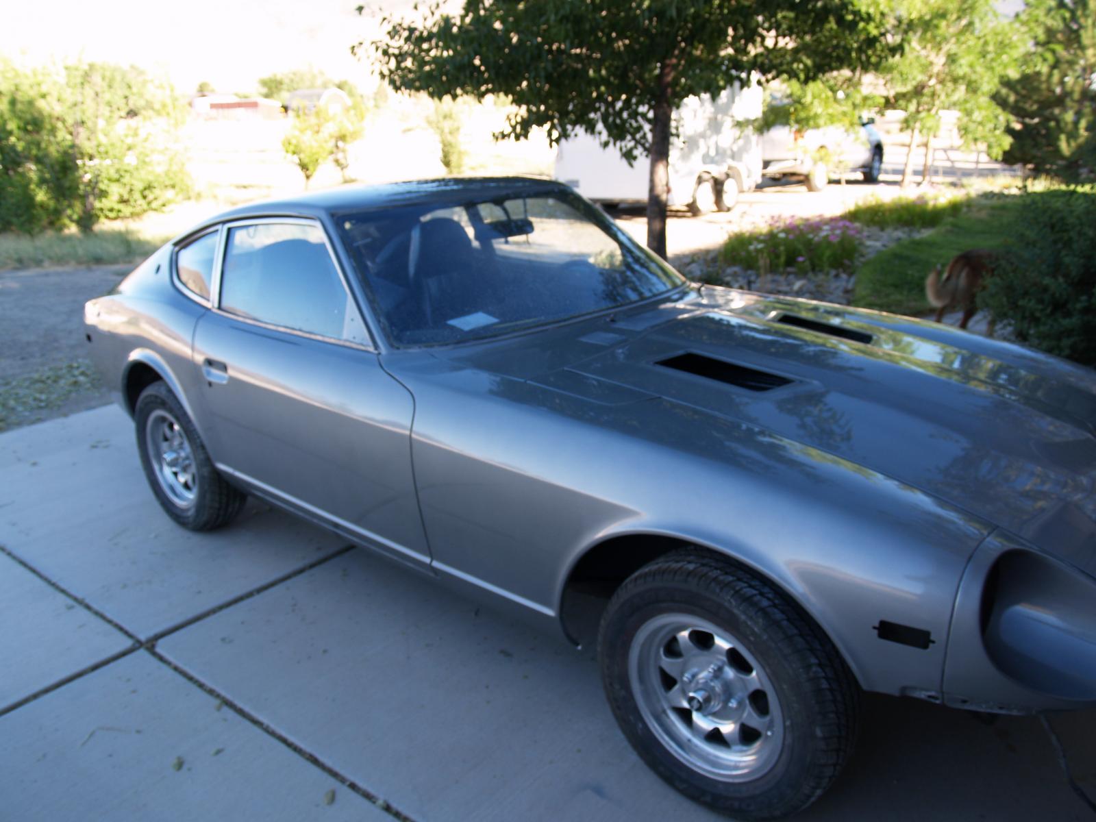

finally figured out how to post pix. i need to pop out that dent too by the way. thatd be easy thou.

Looks pretty clean!

Lol thanx. Yea its clean for the most part, but has parts here & there that r rusted up pretty bad. I really wanna take care of those spots as soon as possible before it covers the whole car

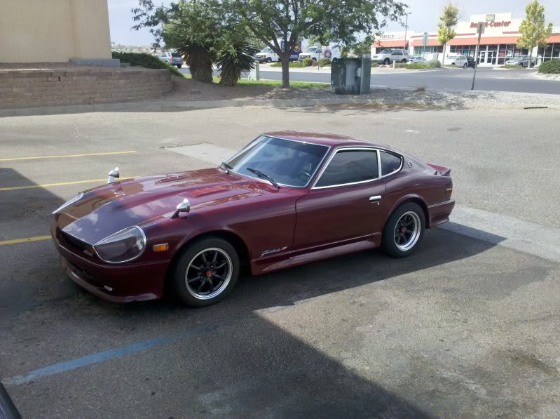

It's been rusting for a long time so get it rolling first. Start buying your tools now. Get hammers and dollies first but don't buy the cheap ones because the faces are soft iron. Go on ebay and buy books on metal bumping and body work/ tools. You will need a wire feed welder to do patch work and a oxy/acet torch for metal shrinking.
Not a good idea to try and cut out the roof unless you have a donor car to cut out. If it's not to bad you can fill in some spots with silicon bronze rod. Sounds scarey at first I know. My '77 was rusty and beat up and after a year of spare time I got this.
