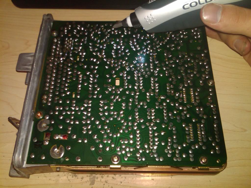

I'm to lazy to get my camera out so heres a cell pic
Old Sep 25, 2010 | 04:46 PM
Looks very clean to me. I don't see any damaged or overheated pins.

I wonder why it doesnt work then. this is the one that doesnt run past 3K rpm
