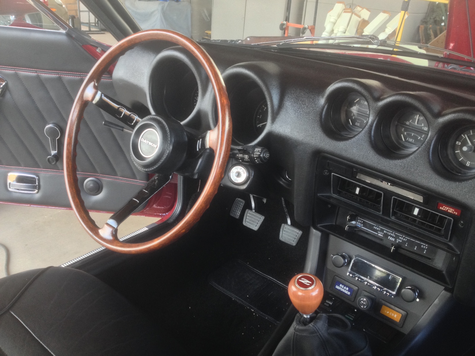

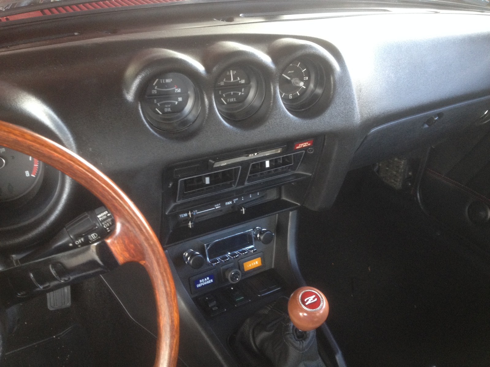

Oh very nice! Is that just an am fm or does it have bluetooth or something?

AM, FM, USB x 2, Aux Input x 2 and BlueTooth. Has a handsfree microphone that attaches to the sun visor as well.
Plays your MP3 and WMA(?) files via USB. Will also interface to iPhone and iPod via USB.
Interfaces to iPhone, iPad and I think Android via BlueTooth too.
4 channels at 25W per, line outputs for an external amp as well as two subwoofer outputs. I'll just go with the 4x25W. These cars, even with sound deadening, are still too noisy to go for super high quality sound from an amp and I also don't need to make everyone around me listen to my music.
I realized that all three other cars have CD and cassette capability and we NEVER use them. All our music is on the iPhone or iPod so why bother.
Liked the handsfree too. Arizona doesn't require handsfree (still kind of the Wild West) but managing a phone and shifting doesn't work too well.
The pushbuttons do act as presets although they aren't mechanical like the old radios.
The mounting system if pretty innovative. The two ***** are physically separate from the main unit and even the display can be separated. All three pieces connect to the main unit via separate cables. It's intended to be mounted in all sorts of older cars, even some that had both ***** on the same side of the radio.
Of course this is all about three times the price of a mass produced DIN radio of similar capabilities, but still, after all the layout of bucks for the A/C, it's almost nothing ...

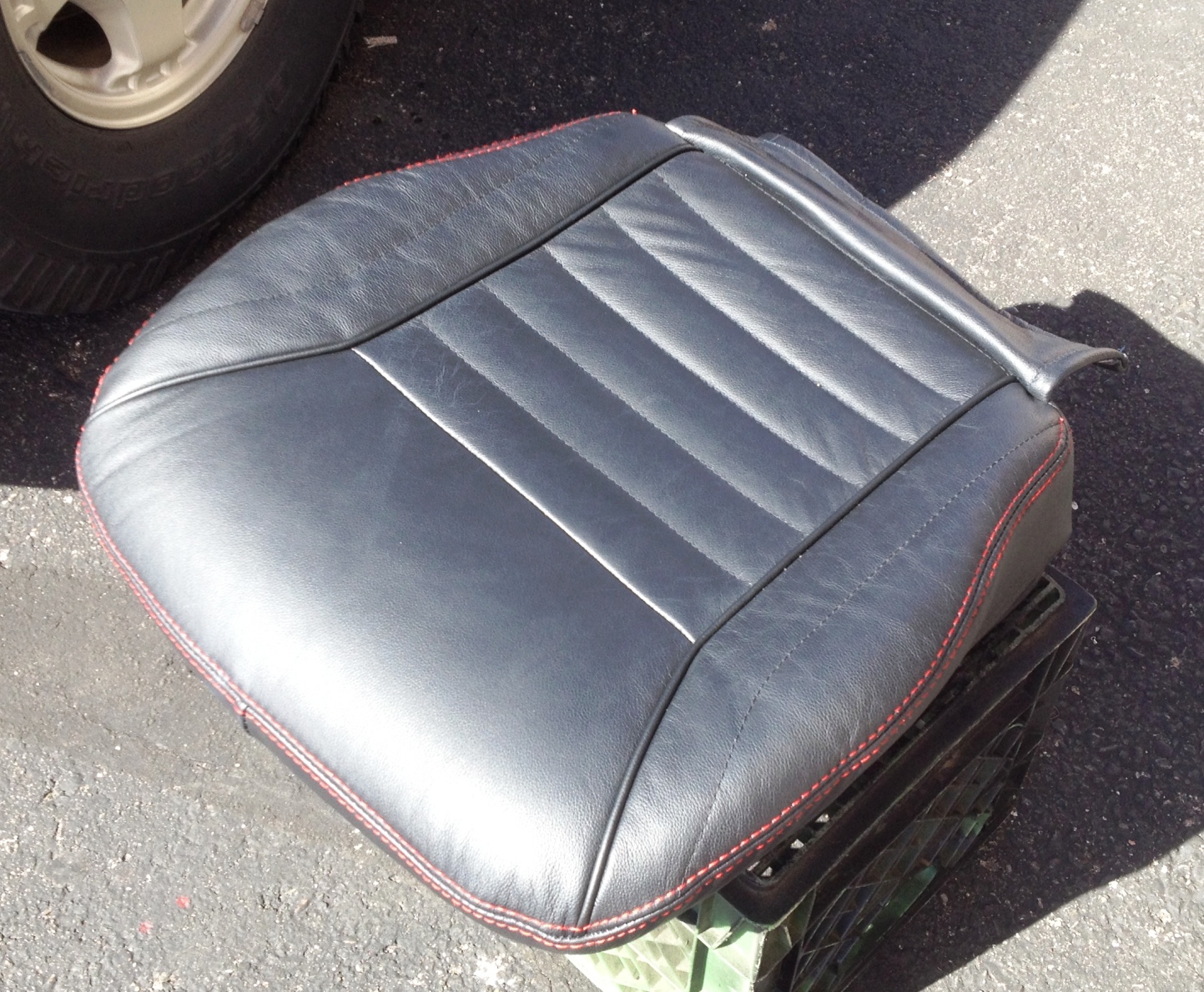

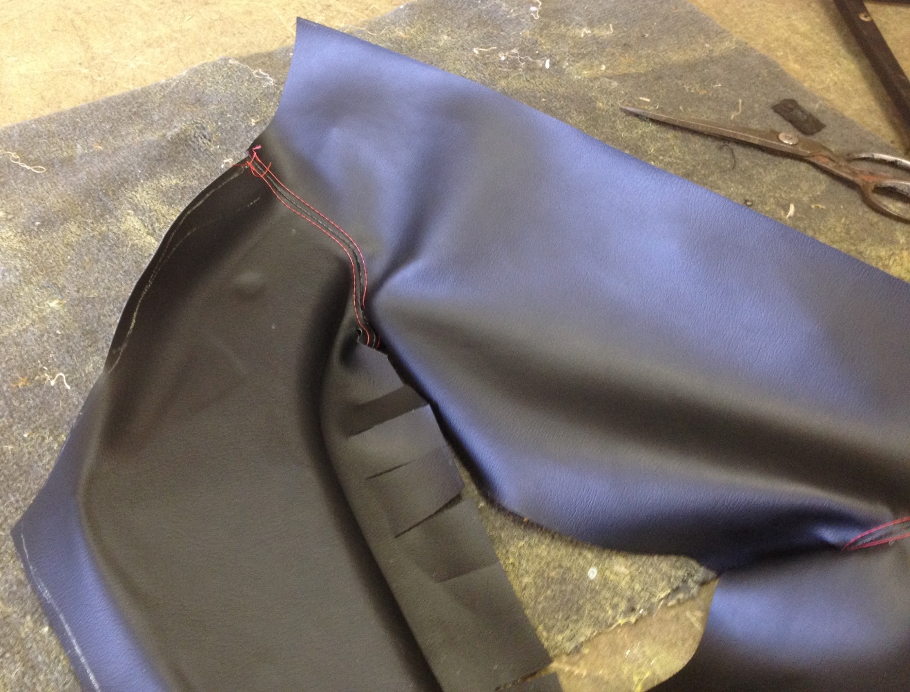

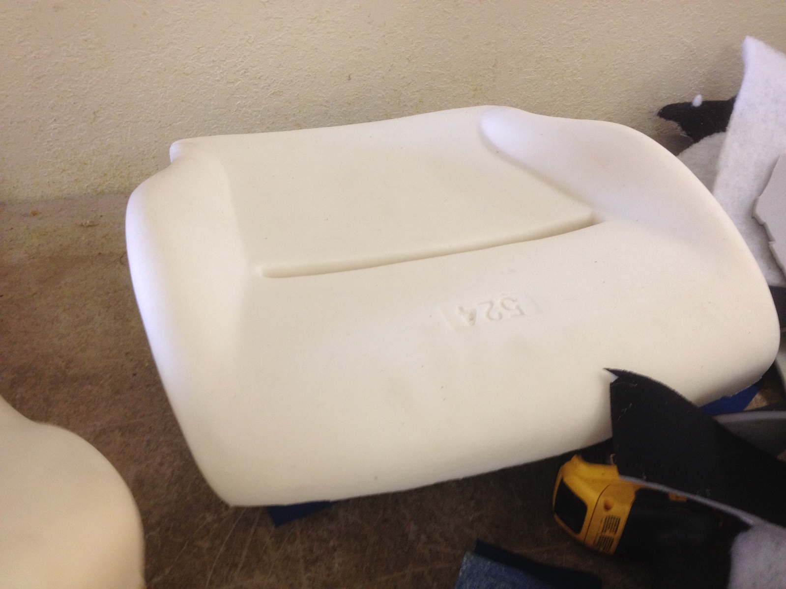

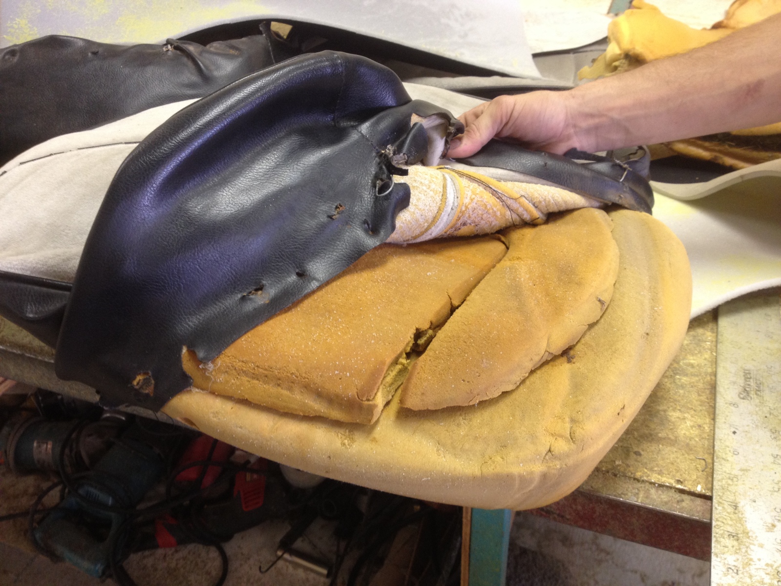

Upholstery Progress
Well it's about time folks. Some visible progress in the upholstery area. Thought I'd share some photos.
Seat cushion pretty well shot ...
New foam looks much better ...
And even better with the cover fitted ...
Original seat back with horse hair stuffing ...
And of course the seat back with new foam and a padded back side as well..
And the cover with fitting in progress ...
This is the door panel material with a 260Z logo embroidered along the old style line. It will be completed with a red stripe on each side and will run around the edges of the panel. The original heat pressed diagonal style lines will be replicated using black cross stitch embroidery.
And finally, all the other panels are being covered (or recovered in the case of the dog-leg panels) with the door panel material. The red stitching theme from the seats will be carried onto these panels too...
I'll be posting more later in the week. Expect the finished interior by Friday!

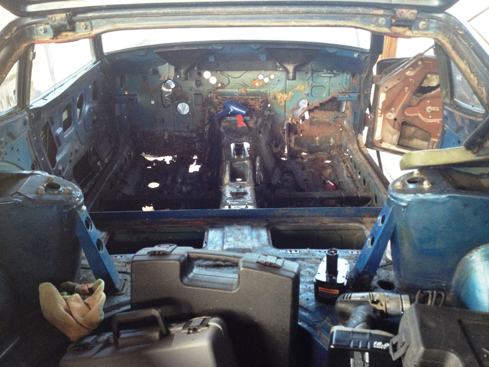

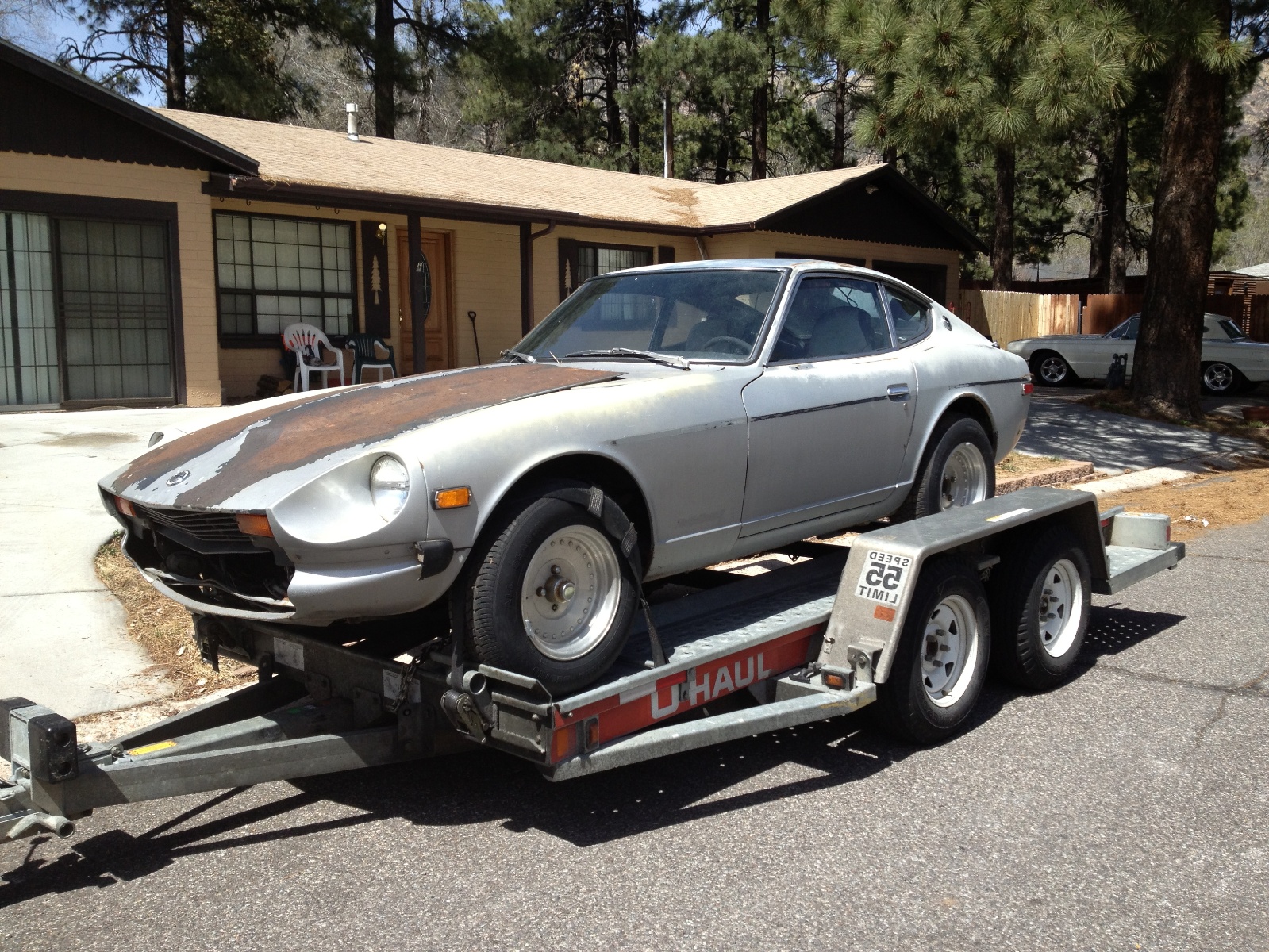

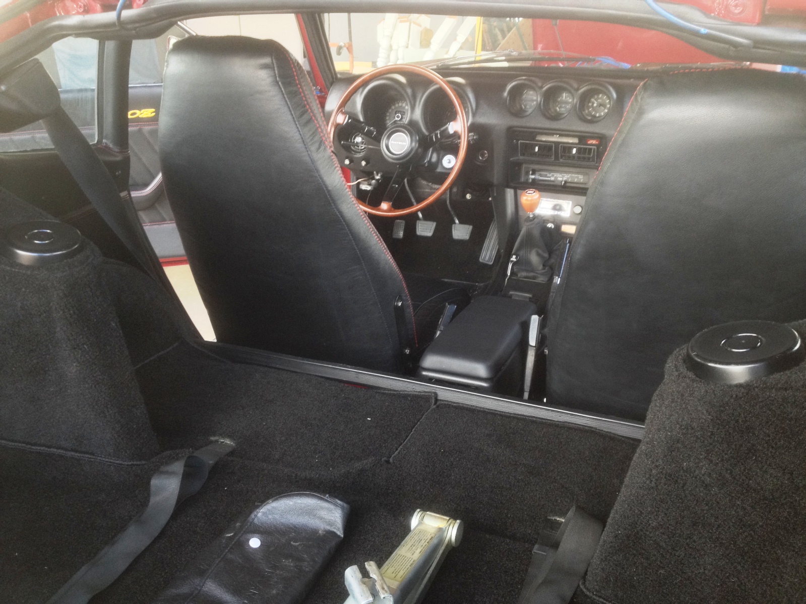

Before and After - Almost Ready for the Show
From July of 2012 when I started pulling the Rust-Z apart to procuring a "parts car" in April of 2013 which became the restored car to today, six days before its first show ... what a journey!
Still have to attach the badges after a final body shop paint polish. There are a few other nits (passenger door lock needs adjusting, rear hatch doesn't reliably stay latched, got to tie-wrap a few wires ...) but for the rest of the week it is pretty much show prep. Detailing, sign board, detailing, polishing wheels, detailing, tire black, detailing and so on.
Did I mention detailing???

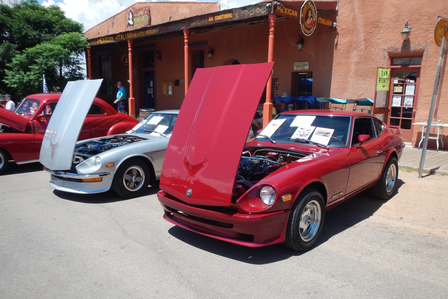

Show Down ...
Originally Posted by theramz
Awesome journey Mr. Scott! It's ready to take the show. The reason it isn't finished is because it will never be finished, it's all in your mind.
You're quite right Tom, it won't ever be finished. I need things to do!

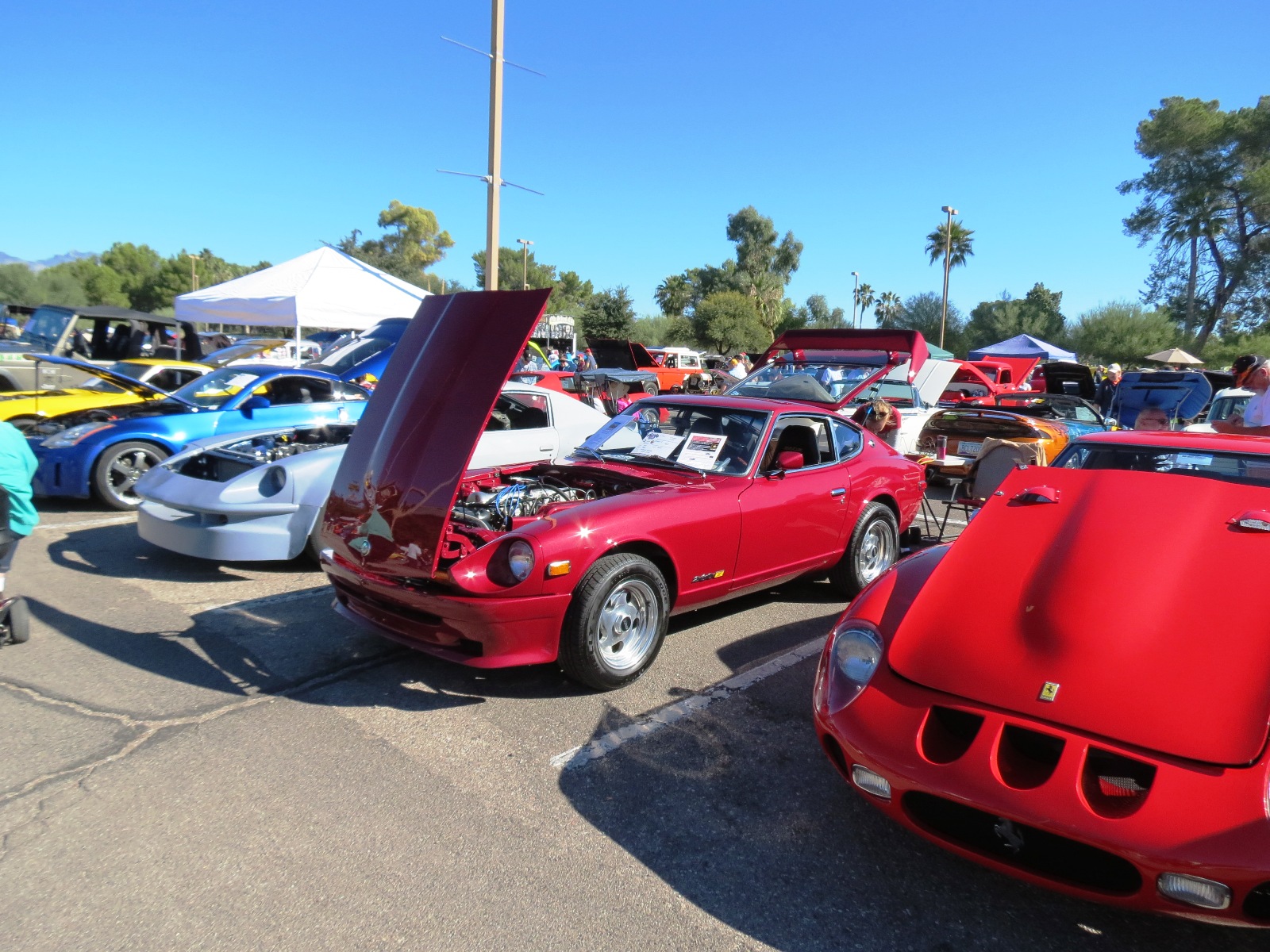

Well, the car show was interesting. It was a benefit with over 650 cars on display and 15,000 attendees. Admission was free and the weather was beautiful.
Judging was pretty much a popularity contest as every entrant was given a ballot and attendees could vote if they wished as well. There were almost sixty categories and each ballot could have at most 25 votes.
There were five Z cars entered in the Z class and three other Z cars entered in different classes. One was a School Shop class another was an Owner Under 25 class and the last was an Under Construction class. The first two of those cars won awards, very nice.
Of the five Zs in the regular class, there was one 240Z, my 260Z, a 280Z and two 350Z cars. The 240Z and the 280Z took first and second. No more awards were given. RATS!
But, there was plenty to be learned from the winners. The 240Z had older paint but was well maintained and clean. Its big difference was the bling in the engine bay. Lots of chrome and shiny stuff. I think I'll be focusing on my engine bay next.
The 280Z was a low mileage (18,000) trailer queen that is completely stock. Of course it looks nice and had a nice set of presentation material pontificating on just how wonderful a completely unmodified car can be. Hmm ... I think I'll have to work on better sign boards. We did have some, but they could be more detailed.
The ugly part of the event was one of the winners was seen (by me) walking around the show approaching folks with ballots and simply saying something like "My car is number XX in the Z Class, would you please vote for me." In my mind, I just couldn't do that. I'd want my car to be seen and judged on its merits to get votes. I'm still bouncing off the walls here.
Now all that said, it was a lot of fun to sit with my club members and watch folks come by and look. It was often obvious when people would just stop, stare and then tell their companions a story. They were clearly remembering good times with a Z car. Nice to know the work brings back good memories. Got lots of compliments on the work so that was nice too.
I also saw a lot of folks with ballots take a look at my car and write down its number. The car was competitive no matter what the result of the ballots were and we'll do better next time.
I think one good approach (next time) will involve being a bit more proactive when folks with ballots come by. I'll invite them to sit in the car and then give them the story as well. Most entries are so hands-off I think that would make a positive impression.
Anyway, the phase of this journey as a restoration project is pretty much complete. The new journey begins with tinkering, maintaining and improving. Maybe there's another Z restoration in the future, I can't say for sure right now, kind of out of room here in the Old Pueblo.
I want to say thanks to all you forum folk who have chimed in and provided support, both technical and moral, to me during this project. Your help was so valuable! Here's to the ZDriver Community!
BTW, that "Ferrari" next to my car is actually a factory produced clone based on a 280Z. The real Ferrari this car emulates last sold at auction for $39 million. It was so much fun to watch people come by and drool only to find out it was really a Z car with a lot of Ferrari components. It was entered in the Kit Car class (shouldn't have been as it was factory produced).

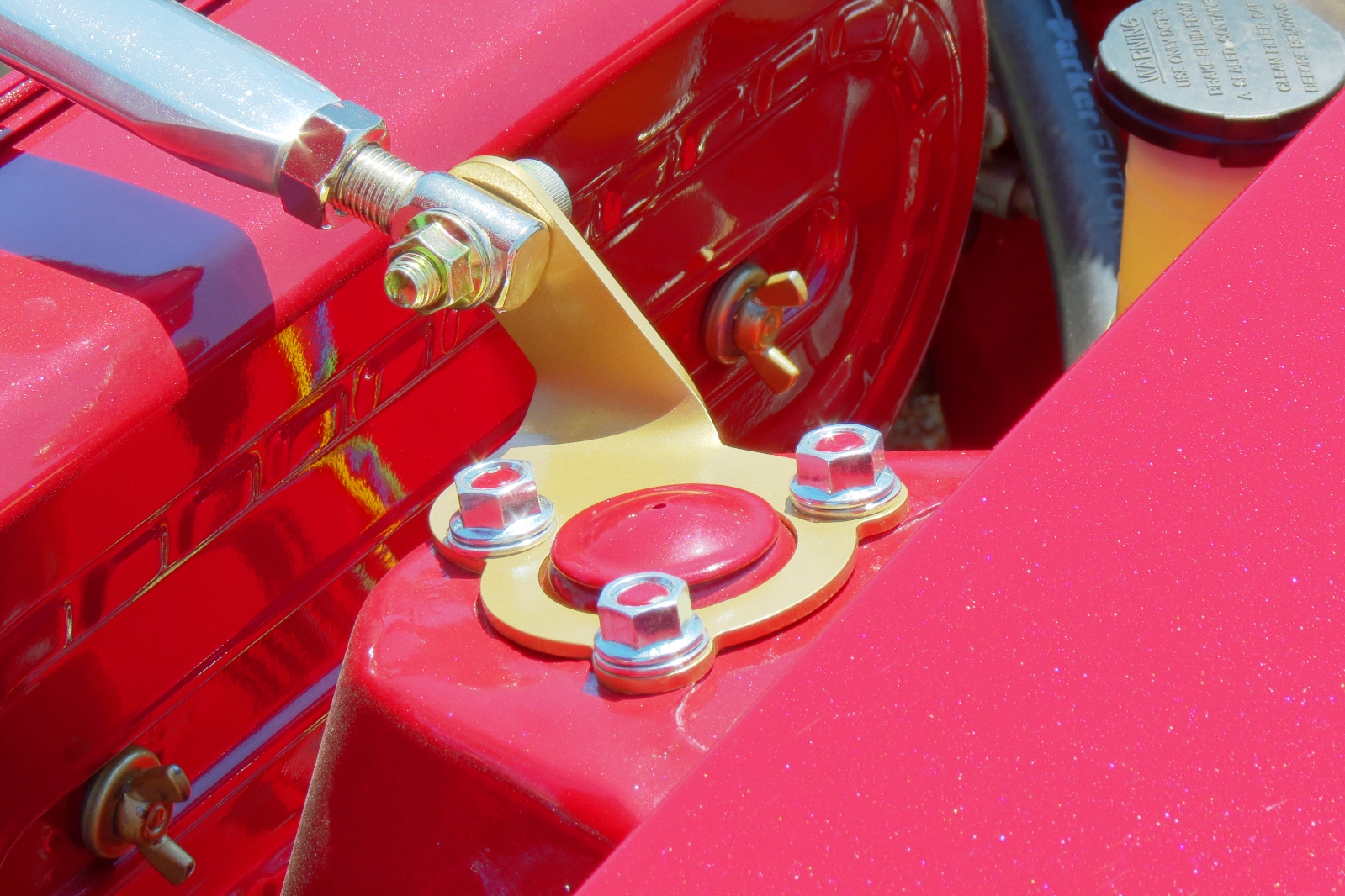

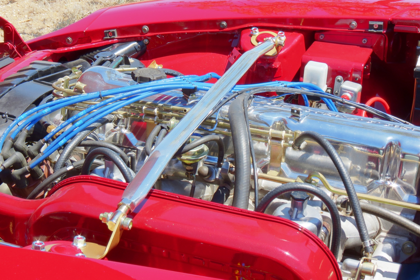

I continue to add bling to the engine bay. Replaced the valve cover with one that's polished. Replaced the old fuel rail with a nicer one that still has its yellow zinc coating and has three pipes instead of two - supposedly more correct for a 260Z.
Adjusted the valves (when I replaced the valve cover) and have been playing with the carbs too. Found out it was running way too rich. Got all that done and the motor is running nice.

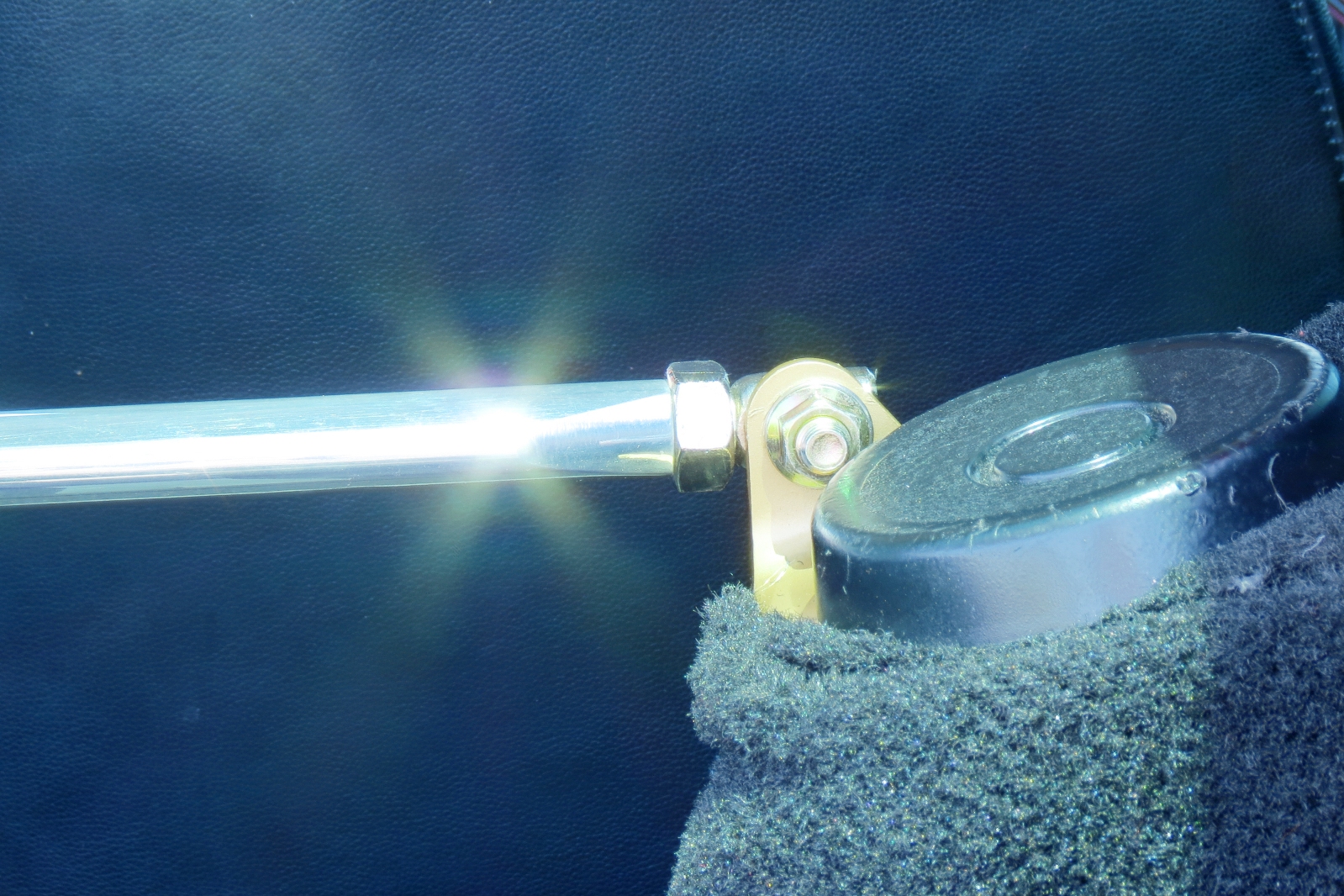

Most recent addition was due to the discovery that "theramz", i.e. Tom, has been selling some nice looking strut braces on eBay. Went whole-hog and got both front and rear. They installed easily and do they ever make an improvement in the cornering.
During the restoration I replaced all the rubber with polyurethane, replaced ball joints, tie rod ends and so on but otherwise the suspension is in a stock configuration. Even with all this, even I could tell (I'm no race driver) the front end would nose in and the back end was a little skittish during hard turns. Once the braces were in, cornering is very well-behaved. It goes where you point it without complaint. Although I don't intend to make it a common occurrence to make hard turns in a show quality car, just knowing I've stiffened up the chassis makes me feel better about the car.
Attached Thumbnails 260Z Restoration as a Retirement Project-front-brace-rl-hdr-resized.jpg   260Z Restoration as a Retirement Project-front-mount-l-hdr-resized.jpg   260Z Restoration as a Retirement Project-rear-brace-1-resized.jpg   260Z Restoration as a Retirement Project-lf-quarter-high-hdr-resized.jpg   260Z Restoration as a Retirement Project-right-rear-brace-mount-resized.jpg

Nice work Scott! I new you would like the bars and performance enhancement. She's too pretty to flog but knowing you could if you want to is enough.

Here are the two Z cars at the show:
The silver 240Z is very nice, I really can't say anything bad other that it is my car's kryptonite. It features lots of chrome in the engine bay, 40 year old paint in good condition with some pin striping, an interior that is "experienced" but in good shape, four wheel disks and so on. No special performance mods.
