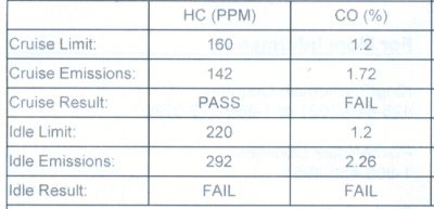

I need some advice or suggestions on my ongoing battle with the Pulsar.
CA18DE - DOHC, coil packs, MAS. so no distributor or wires, and no adjustment on the Mas Airflow Sensor like an AFM has.
Here's the history:
Got the car this summer, PO said it never had an issue with emissions. No problems at all except for the transmission.
Well, fixed the rear engine mount which was the problem with the transmission. Also fixed the radiator fan that didn't work, engine had a stumble and rough idle, and it won't idle at all when cold. (cold start system?)
Warmed it up, drove through emissions
161,287 miles
Has rough idle, new spark plugs and that's all
Replaced coil packs, that fixed the rough idle and stumble
161, 391 miles
Idles good (once warm)
then I lost the key for about a month so the car sat
I replaced the oxygen sensor, back the ignition timing back and took it for a longer drive the morning of the test.
161, 479 miles
At least there are some noticable improvements this time. Still failing at idle and barely passing the CO % at cruise. What's the deal here?
Could it be as simple as needing a new cat or is it hard to say?

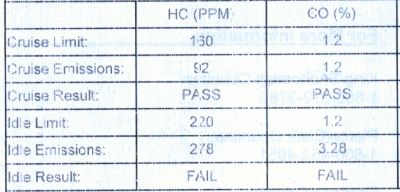

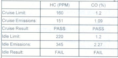

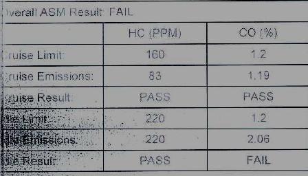

I removed the air filter and ran a tank of gas through it with injector cleaner. Then I added some special stuff that Shady suggested.
It got a lot better, but still failed one test at idle!
numbers from last test were: [ 278 ] - [ 3.28 ]
it is a MAF and I already adjusted the timing. Previous owner had it advanced a lot. I brought it back to spec.
The special stuff was water seperator/fuel anti freeze. methyl hydrate. I added 24oz to about 2 gallons of gas. That's pretty high percentage. A bit more than Shady suggested. I suppose I could try another $15 test and another 6 bottles ($12) of special stuff.
