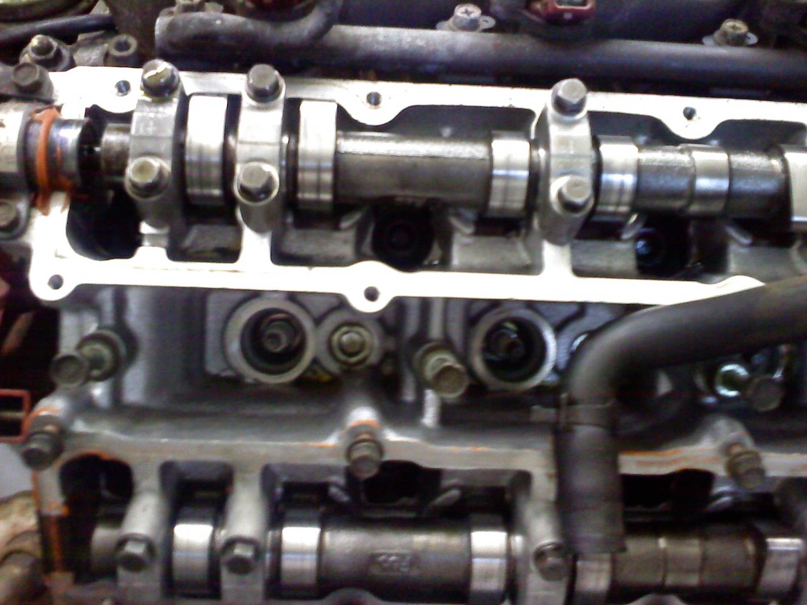

This is the dry side. its like its never seen oil .

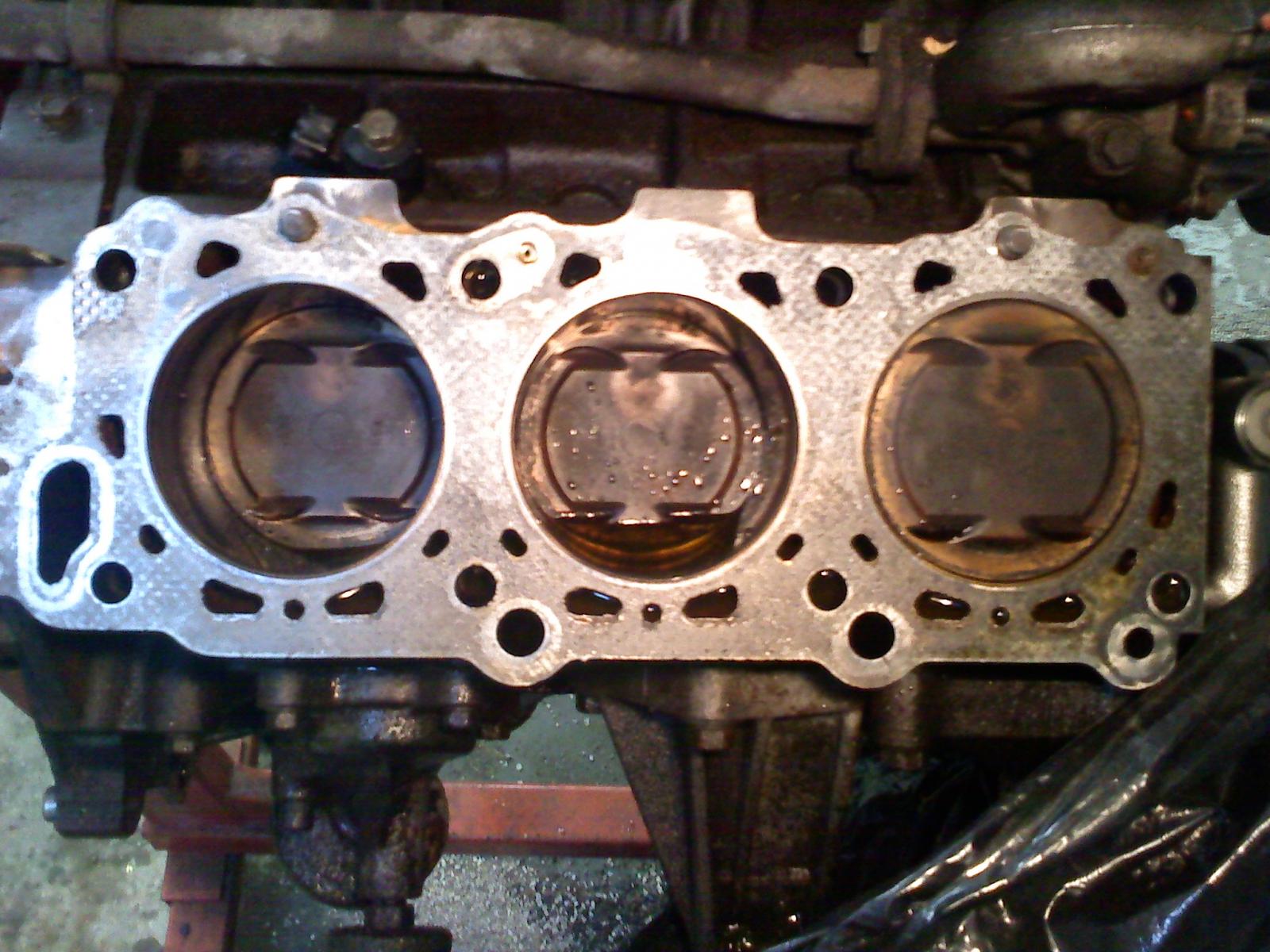

I took the head off, an this is the block. Do you happen to know which holes are the coolant and oil gallerys, oh and which holes flow into the cylinder head and out the head

I'm fairly certain the narrow jets are the feed passages (visible between and above the left two cylinders and at the top right corner on your pic), and I think the large round openings (not for the head bolts obviously) are the oil returns. The odd-shaped ones should be coolant, I believe.
Was there any oil on the head bolts? The cylinder head doesn't need too much oil, as cams rotate at half the speed of the crank... your pic is inconclusive in terms of whether or not oil is getting there.

There was oil . I just compared both sides. One seemed alot lower on oil than the other side. The reason i took everything out was because of this dang ticking noise. fairly loud louder than the motor when it runs seemed like to was coming from the head/valvetrain. very puzzled. oh thanks for the help too

just cause the heads are clean doesn't mean anything other than the oil was clean. look at the cam lobes, a slight center trace wear on them, but otherwise smooth, not scored, nor showing any signs of getting head up which would happen with bare metal on metal. maybe it is time to replace the sender unit and clean the oil passages out with the old ATF trick and replace those ticking lifters. but oil flow is NOT your problem from what i have seen or heard so far. trust me. if its not running right, i'd look into a electronics problem. our brains are tricky like that, we sense a problem, and cause we notice two of the same parts that appear different we tend to believe that is the problem. but i think you are just worked up. the head looks fine and like it was in great condition, if anything, its the one that is dirty you should have been concerned about.

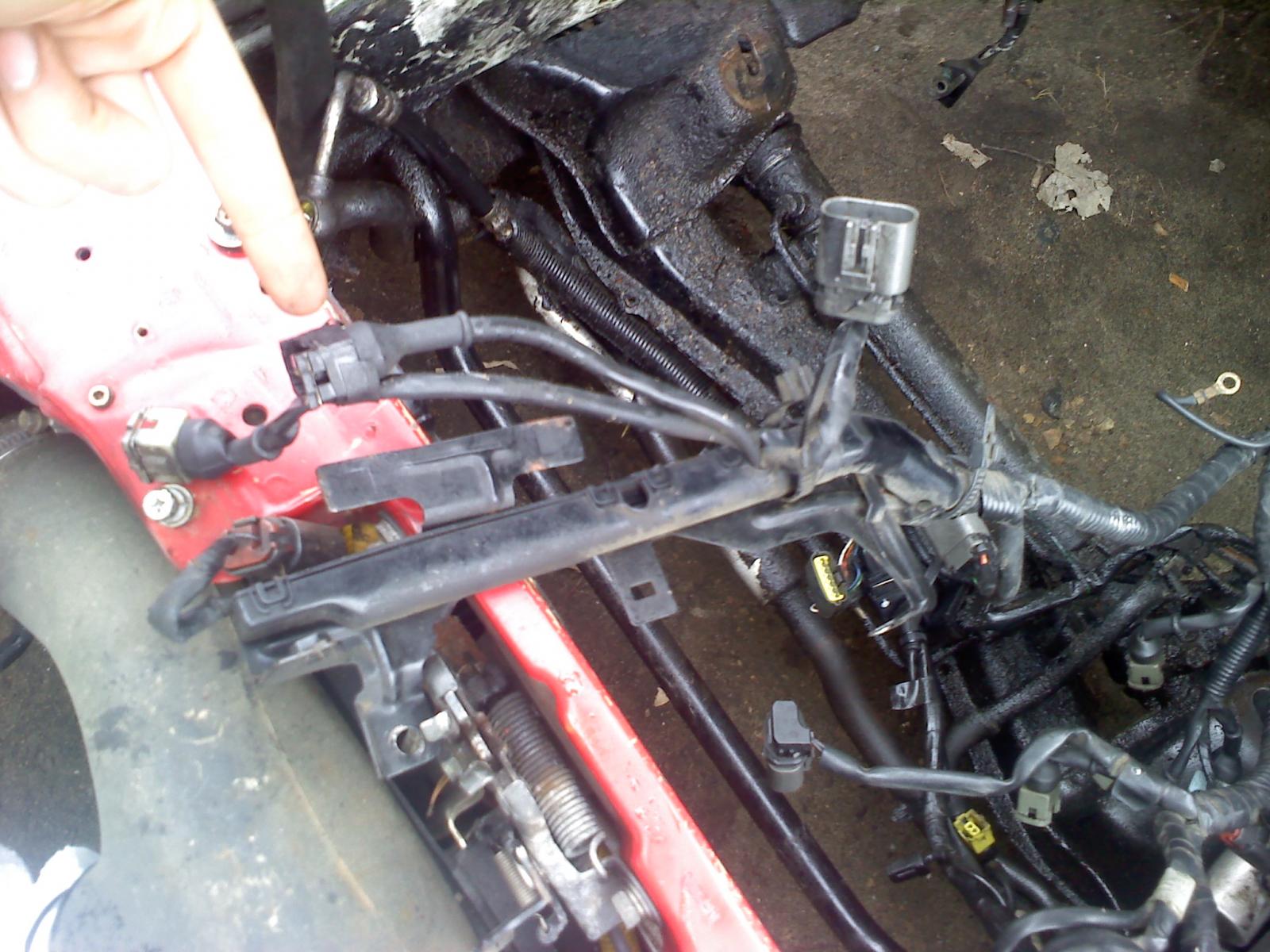

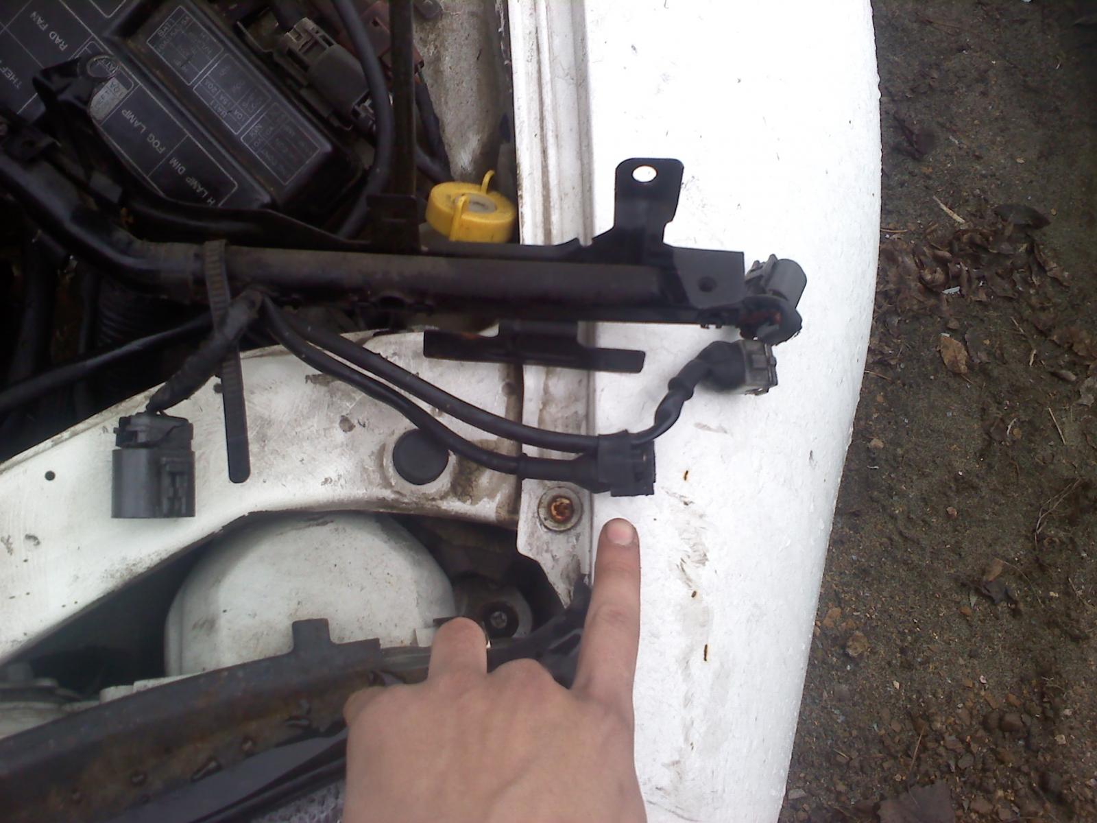

i have a question when i removed the motor there was a single plug that wasnt pluged into anything. its the engine harness on the passenger side . it has a metal bracket with engine harness wires and it mounts to the passenger side cylinder head and for some reason who every had it before me just taped it up . in the picture im pointing to it . if i didnt take the motor out myself i prolly would never have noticed that it wasnt pluged in.

that might be for the EGR solenoid. is your EGR deleted?

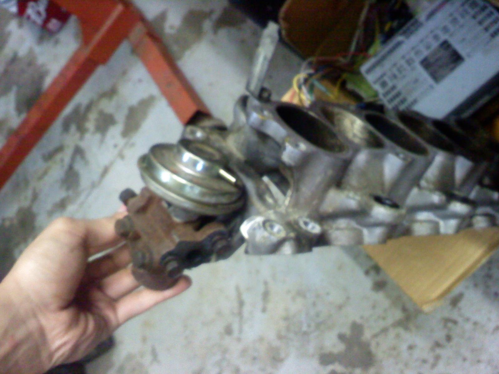

this is the egr right ? this is on the back of the intake manifold

yeah that is. many people leave the valve there though to pass visual inspection after it's removed. ensure that it was hooked up properly. if it was, then that plug wasn't the EGR one.

Those plugs are for the OEM wastegate solenoids, if memory serves. Does your car have a boost controller or Stage III ECU installed? (If it's a non-turbo, they'd just be unused connectors - I've never in my life seen a harness where every connector is used - they save money by making a harness that can be used in multiple cars.)

i got an N/A. if i cant find where that one gos than ill just leave it, i was just wondering if it would make a big difference.
