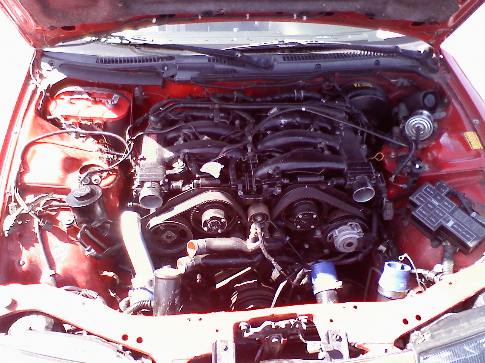

i have just started a 300zx tt project that i just bought. i need help with some electrical problems. when i got the car it had no battery. so i popped in a optima battery and tried to turn on the stereo, roll down the windows, and turn the headlights on. non of this worked. the interior dome light worked and the check engine light and battery light turned on and that is about it. also with the headlights off the engine oil pressure goes all the way up and than makes a ticking sound and jumps a little bit with this little led thats next to it. i think it has something to do with the alarm system but im not sure. also there is alot of disconnected connectors and wires that i dont know where they go to. so if anyone has a go site that has a layout or good 3d pictures or something that would be great. than i have to install the radiator and alot of turbo piping. the shifter has to be hooked up to the tranny. and i have to put in a brake master cylinder and i was told this is somehow connected to the clutch having no pressure. any help any can give will be greatly appreciated. im not sure where to start on this project especially since the car never came together. ive only seen it taken apart. so i dont know exactly how to put it all together.

here is the car
here are some pics

To put something like that back together, one needs to have decently intimate knowledge of the Z32. And if one has decently intimate knowledge of the Z32, they wouldn't be asking for pictures of where everything goes. Not trying to be a dick, but this isn't a Civic or old muscle car where you can look at the engine bay and know what everything does and where it goes.

agreed^^. it's hard to explain where each connector goes. you might be able to find it from the diagram though if you are willing to take your time. also, before you start it, make sure you check that all the grounds are in place. some grounds missing can cause damage, and if all those connectors are off, you might have some grounds off too.
shifter hook up is pretty easy. remove the ds and exhaust to make it very easy.
the clutch system and the brake master don't have anything to do with each other as far as i know... i've had each of them go out and neither has affected the other. if your clutch has no pressure, it needs to be bled. if you bleed it very well and still get no pressure, then the problem is one of your cylinders (master or slave). it's hard to tell which one unless one of them is leaking.

well while everything is apart you should start with some timing covers and not to discourage you this is probably a $500 job doing it very cheap just for the engine bay. and you should listen to zlover he knows what he's talking about. if you don't know what your doing it's better to just send it to a shop so it gets done right the FIRST time.
