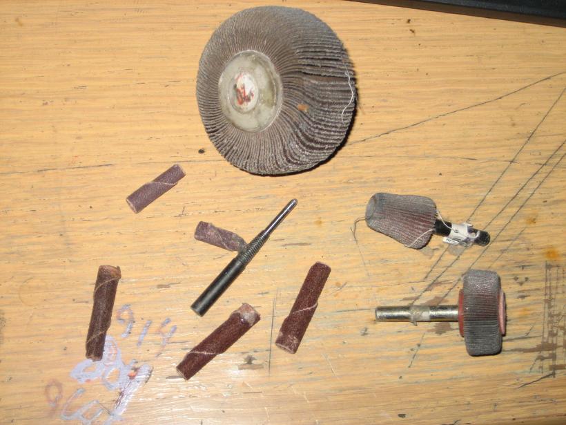

here is a picture of a few flap wheels and tootsie rolls that i use. the flap wheels retain the shape of what your sanding, as long as you keep moving it back and forth and dont stay in one spot. also always sand down the high spots to get to the low spots or you will ahve divits in the metal

hmmm.... you know if instead of wrapping pens in the sand paper you wrapped a drill bit in it you could made a custom rotary sander saved some time and strength.
yes I could do that but that is what the tootsie rolls are for, the only reason i used a pen is because i was down in the 400 grit range and I wanted to hand sand. also im curous to know how you would make the sand paper to stay on the drill bit, also the ridges on the bit would chew right thur the paper

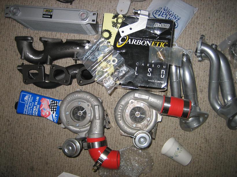

ok guys new parts in yay!!!! i HAVE A NEW cARBONETICS Carbon LSD, earls oil cooler from Z1, 3 inch labree pipes ate brake fluid, chomonmly pivit ball new throw out bearing, brake clyinder brace and spl shift bushings, oh and the kill manfiolds they are F**** awsome never seen a better design b4

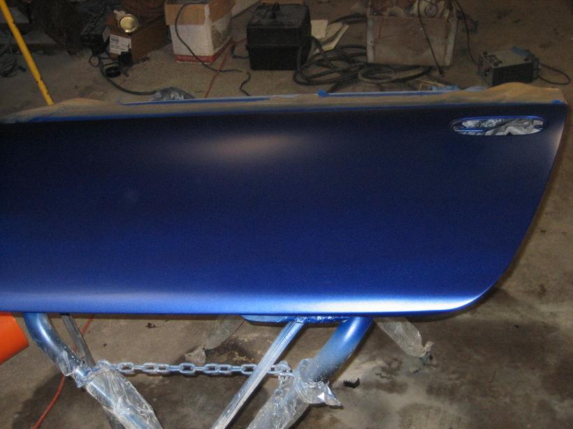

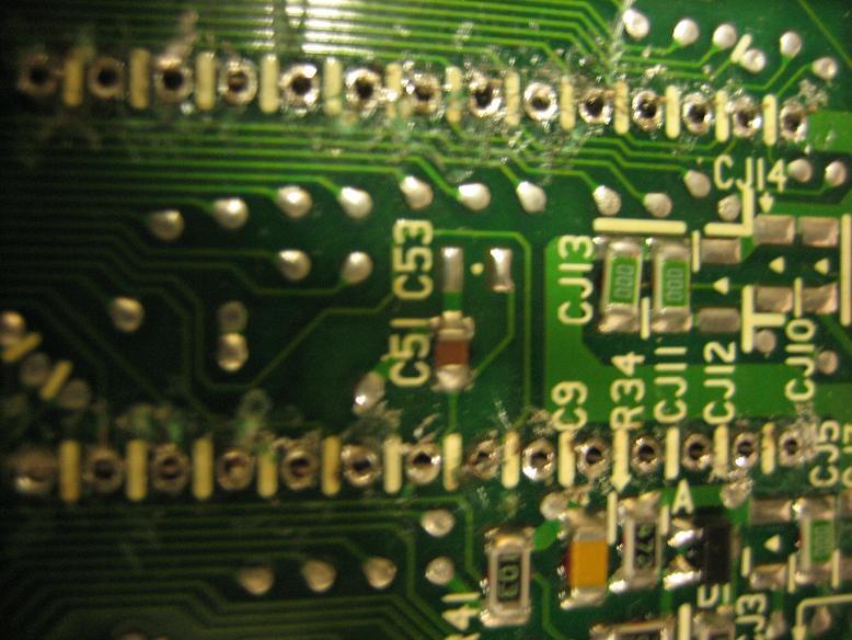

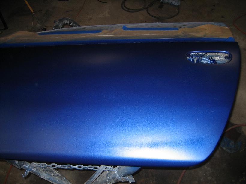

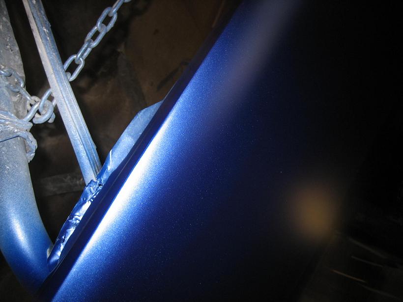

thanks bro here is some pictures of the color only the base. the reson for the color is i want it to some what look black at night but when the light hits it its blue and where theres no like its black you will see in the pictures what im talking about with teh camera flash. als i socketed 2 ecu's so i could have 4 computers. for differnt setups why i wait for my aem to get here i have to clean the circuit board the flux from the solder is all over it. The color is lapis blue base, followed by colbolt kandy, then laying some serous clear on and its all geting a show finsh no orange peel. ( i hate orange peel)
