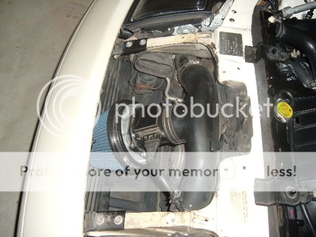

Is this the mass air flow sensor? that square looking thing? hmm..
also, whats the proper name for the cas plug?

the maf is under the center pannel where your air filter is (between the headlights) its 4 bolts.
the cas is on the front of your engine on the right half it is silver and attached by 3 bolts do not take it off just pull off the plug check the connectors tweak them and re attach

yes the black thing with the wires coming out of it
