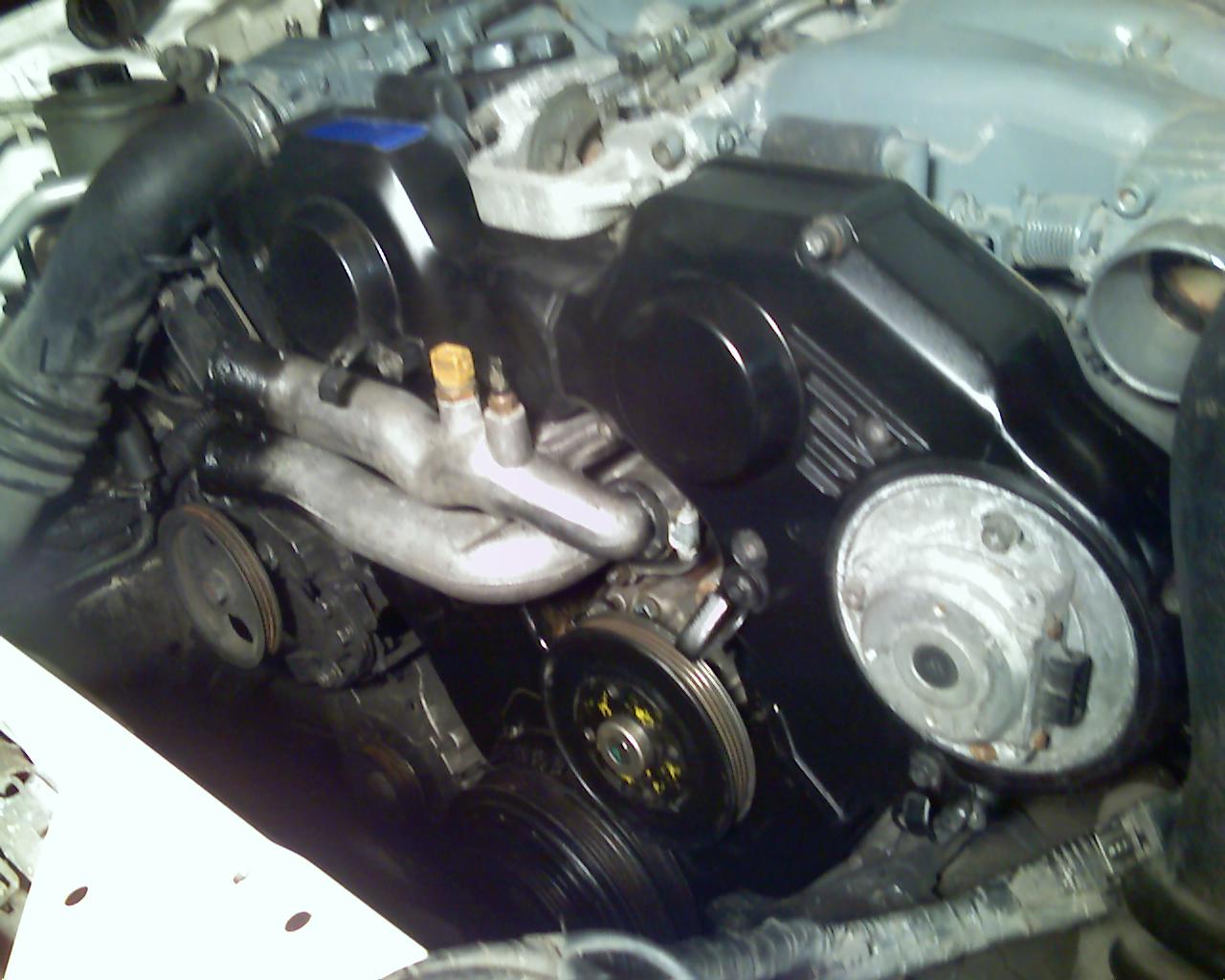

here's some pics before and after looks nice now
Attached Thumbnails Balancer removal-090419_142022.jpg   Balancer removal-090419_173102.jpg
