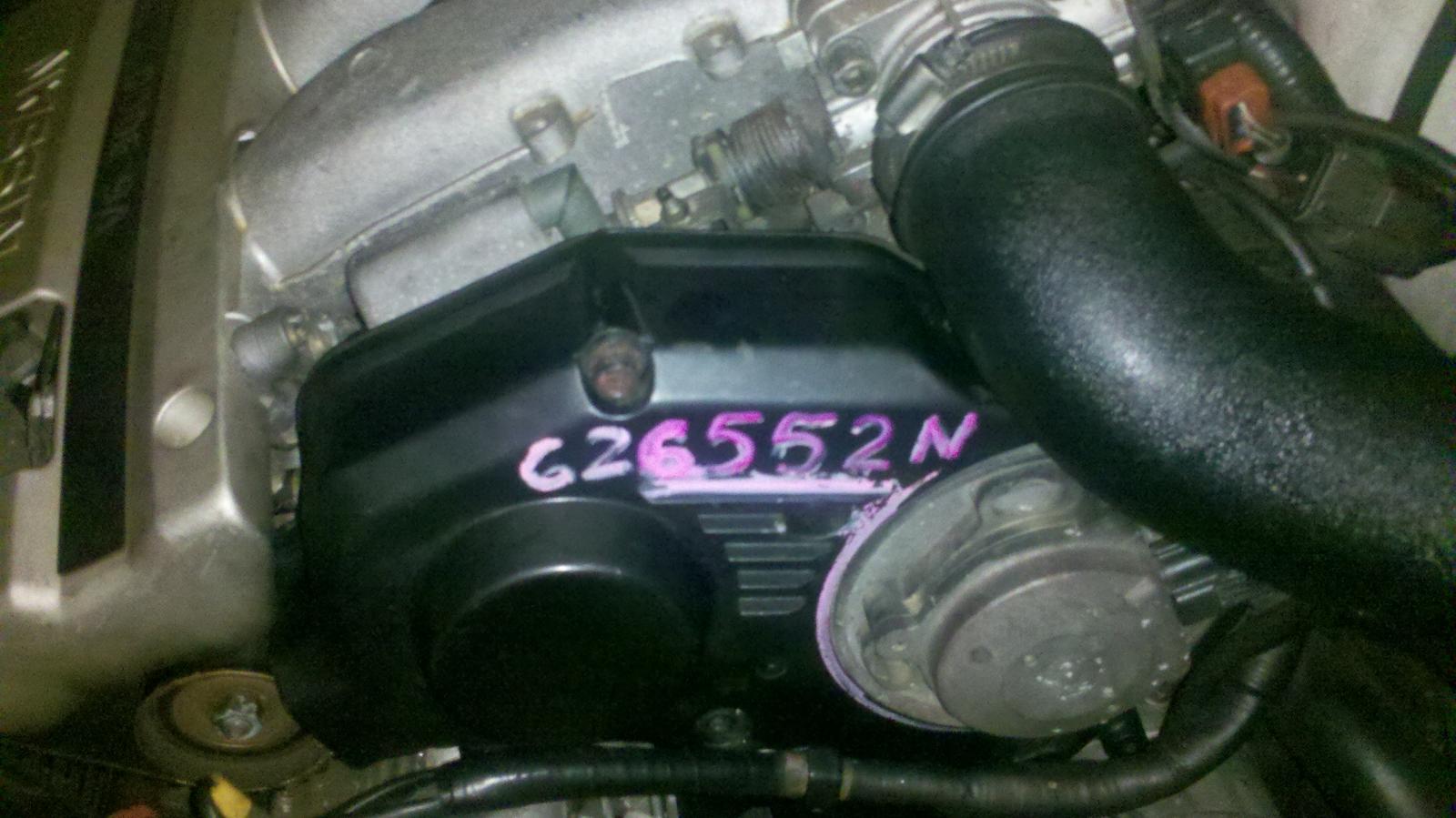

I'm a new Z owner, on a whim I picked up a non running 1995 Auto 300Z 2+2 for a grand. The Water pump was rusted out and I'm starting to see some backyard mechanic "work" on this car. The timing gear cover has been hacked off in places, hoses have been either removed or dry rotted, the engine it's self looks like a JDM replacement(Guy at Nissan told me that). I don't even know were to start making repairs on this car, but I wanted to say hello to everyone and get some pictures up.

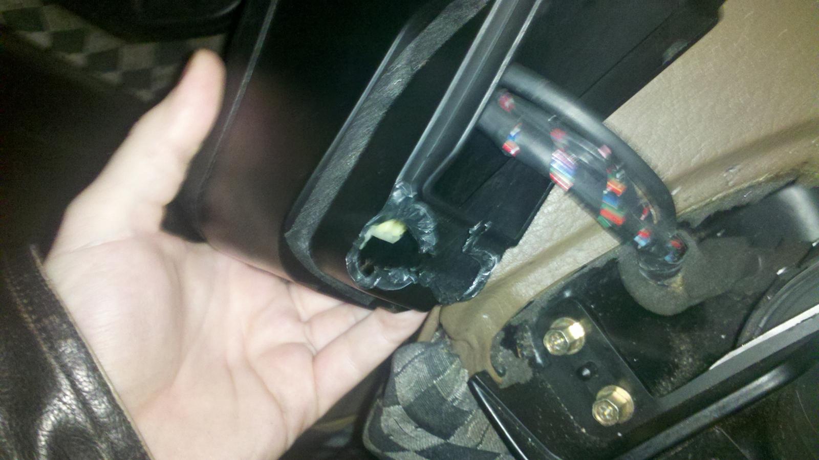

Issues I've found.
1) Left console panel is broken and just hanging there.

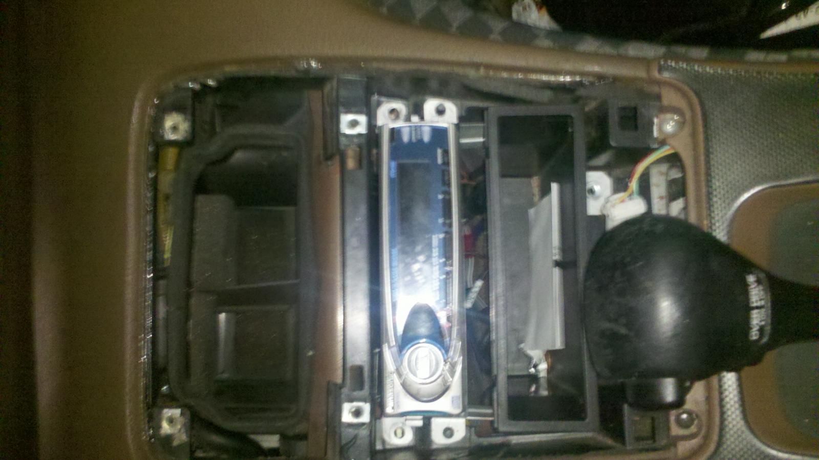

3) Stereo System is shot, will need a new head unit wire-kit and Panel accessories cover.
2) Clicking noise coming from fan on the t-bar (Fixed by popping it off and adjusting the screw)

Good Luck on your Project.. You will find it a REAL PITA to get the Intake off, to do any injector work.. Took me three hours to get mine free.. After that, it only gets a LITTLE faster.. If you do the 'Throttle Body Coolant Line Delete', then it makes the Install faster also..
Some people do not run the Cam Belt Cover.. I prefer it.. does not look so 'Rice'..

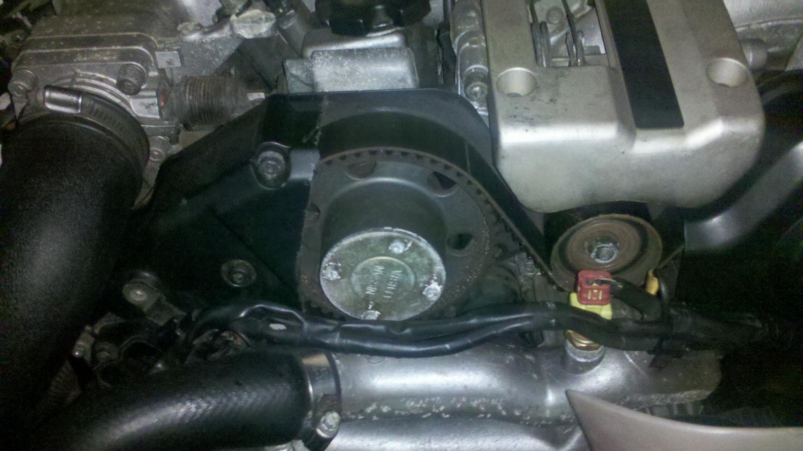

I'd pop out the Plugs, and do a Cold Compression Check on yours.. I'd expect to see something in the low 100's .. don't worry.. we are just looking to see that it Spins and has Compression.. MIGHT be some rust on Valve Surfaces keeping the Compression Low till se Runs for a Bit..
If it Can do a Compression Test, and not knock or Bang.. then might try and Start it.. With the Drive Belts Off!!
The Squeek.. ???.. Pop all the Belts Off (EXCEPT the Timing Belt) and see if it still makes that noise..
The Low Oil Pressure COULD be it's low on Oil.. as it is SOMEWHAT hard to read the Oil Level.. I know the 91 ( It's Gone Now ) has run out of oil before.. it still shows on the Dipstick, but the oil really is not there.. it's just oil from the Tube getting wiped on the Dipstick.. Check it a Bunch of Times.. Usually when it's that low, the Pressure would Rise, then Fall, as the Oil was Pumped to the Heads..
As for the Squeek.. if you still have one, with all the belts Off, ( except the Cam Belt ).. then it is the Cam Belt Idler SOMEWHERE.. TURN IT OFF!!!..
If you have a Bad Cam Belt Idler, and the Belt Jumps more than a Few teeth, then the Valves are TOAST.. be Warned.. I've had my 95 loose an Idler, and jump one tooth on the Right Bank.. did not kill anything, but was worried about it.. Got lucky on that one.. Ran like Krap, and Sounded like a Subie.. And a Bad Squeek that was hard to locate..
