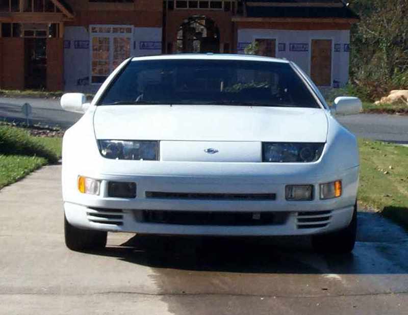

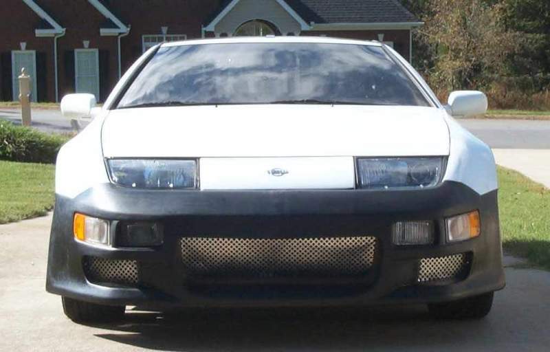

I have installed the Greddy style urethane front body kit. I am posting a before and after shot. I have yet to prep and install the BOMEX front facial. I want to route out the openings in the facial and install the same type of screening / mesh as I did in the body kit's openings. I used some clear plastic to splice into the plastic skirts to make up the difference with the new body kit. I sealed the extra plastic into the old skirts using silicone and then pop-riveting them together. I installed new clips around the perimeter of the new body kit to tie in the modified skirts for ease or removal when needed. I got the new carbon fiber hood in today. It looks awesome. I think that I will have the car painted with the stock hood so that it matches, then install the CF hood. I haven't made up my mind if I should have the body kit painted black or simulated CF to match the hood or not. I am thinking of having the car painted pearl white (white-white) with a blue flake. What do you think?

personally, I liked better with the OEM fascia, but the Greddy looks good too (I just prefer OEM over most bodykits). As far as the paint, I have white with blue pearl and it's gorgeous IMO! You won't regret it, but does your car need paint?

Obviously the avitar that you use doesn't have the OEM / stock front end on it. Mine does need paint. The front end had been hit. Front left fender and hood was replaced and doesn't quite match. Also there is some slight body damage to the left rear quarter panel that I would like to get fixed. I always loved the pearl white paint job on these cars. I have a '93 NA coupe in pearl white, but it is not a true white, it is an off white. I want this one to be the white-white pearl, which will off-set the CF hood more, and I think that it will look better.

well....that's my old TT, it had the stillen front on it when I bought it. I now have one with an OEM front. Personally, I like the jspec and the stillen lip..... and oem. just my taste. Some kits (like Greddy, stillen, WW, etc) aren't bad and look good, but I just prefer the more stock look. You're getting a CF hood? why? they're not lighter....so it's purely cosmetic....just making sure you know that before you shell out some dough.

I think it looks good. Better than the oem "tucked under" look at the bottom. Imho, I think it'll look better if painted body color. I also would prolly pull the bottom sides in to where they're vertical and even.
