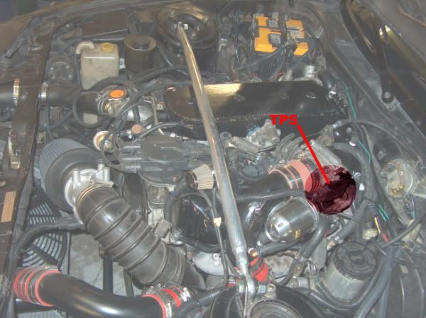

might want to check the TPS (throttle position sensor) and its connection.. clean the connector and make sure theres no moisture in there..

where is the throttle position sensor in this car I am looking under the hood

the TPS is on the throttle body on the driver side of the car. If you stand on the driver's side of the car and look at the throttle body you'll see a thin black box and that is the TPS. The airflow sensor is another possibility. If you know anyone else with a Z31 see if you can try out their MAF. Also another thing you could do, is pull off your MAF and check to make sure there's nothing blocking the little grating covering it.

Old May 28, 2006 | 12:16 PM

do you have to open this black box I see two scews ? That I assume is here it is to clean ?

no just disconnect the electrical plug and clean the terminal... blow air in it or use electrical contaclt cleaner.. make sure its dry..
