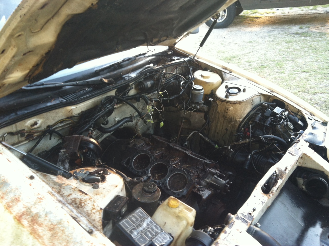

ok so this may be a typical question and i obviously know the compresion is diff.... but is anything else? or is the block and everything identical except compression? i ask this is because im restoring a shiro that was left outside for 14yrs.... the top half of the motor along with turbo is all in the trunk and looks new....... but the bottom half has been under the hood sitting..... and i know it would need lots of machining if it were to get running condition again..... but we have a great running NA thats been in a accident (in rear... tottaled) and i was wondering if we could use the N/A block on the stock turbo head.....

https://www.zdriver.com/forums/attac...g_9873-1-1-jpg
this is the block

Do it
The NA motor is a higher compression ratio, so with the stock turbo gear will bolted to your NA no problem, you will have just a little more HP bump from the diff in compression. Many an NA has been converted to turbo with no issues. I'm currently looking for a Turbo parts car to upgrade my NA.
