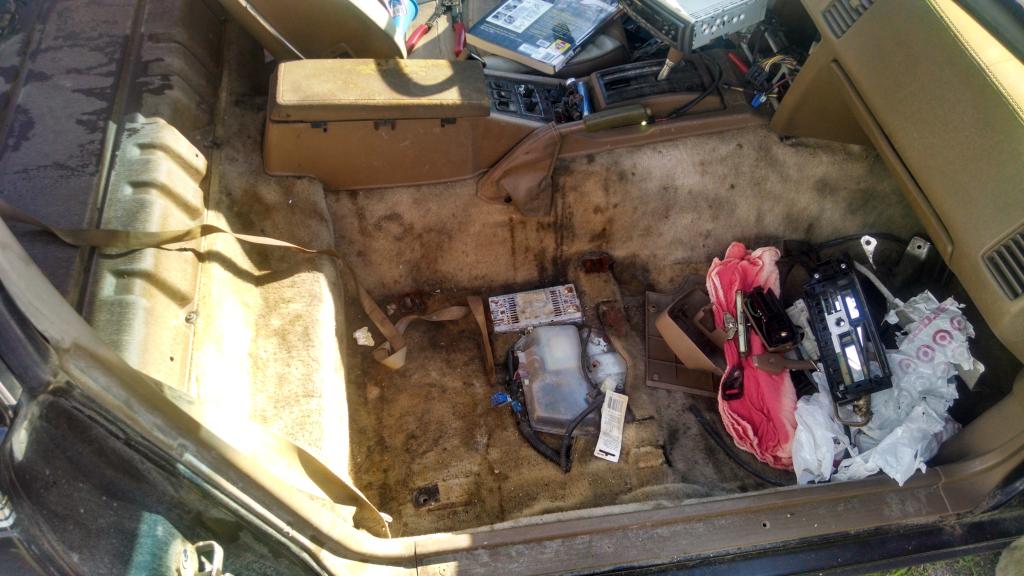

Don't have any pictures of the inside right now, but it's pretty rough, the seats are dried out and the dash leather has split in a few places. I'm not too worried about it because I like doing interior work. My least favorite part of the car is that it's an automatic, I hate automatics with a fiery burning passion
