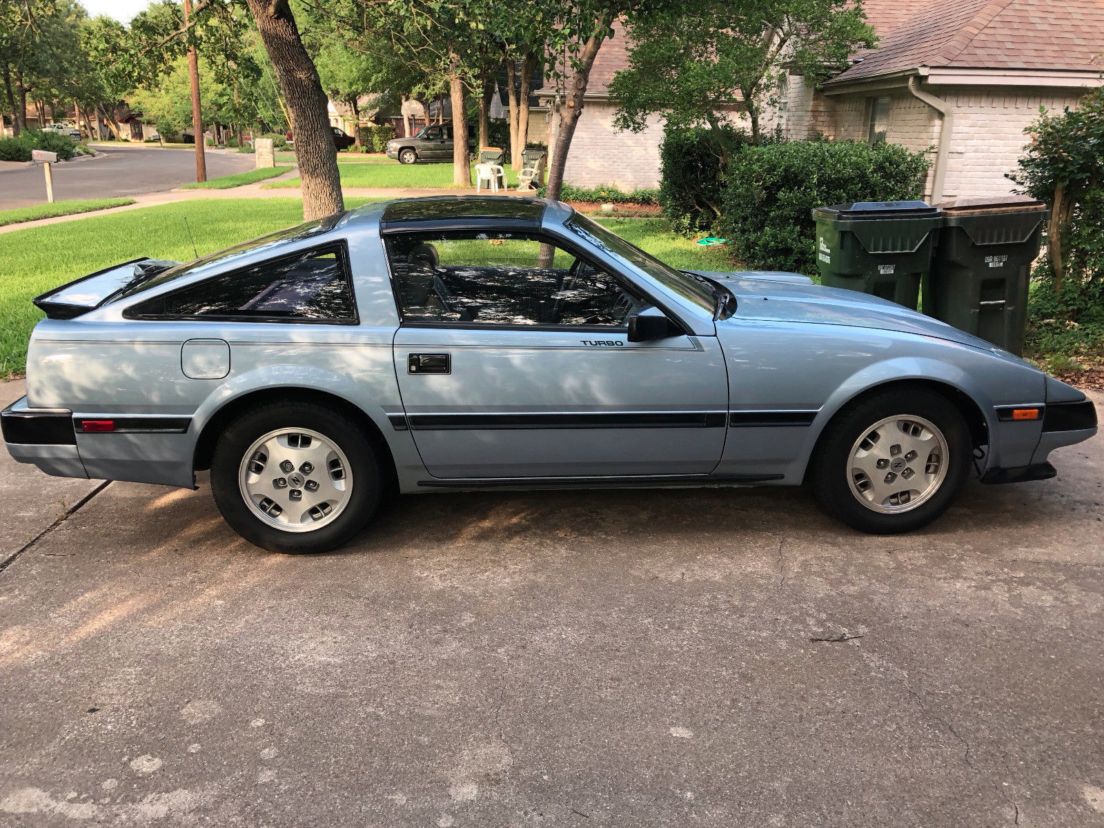

O.k., I broke down and bought aftermarket Kenwood system, still trying to get the original radio repaired. Install went great, was able to attach antennae switch to face plate. Used original harness back to car, now antennae won't go up or down, it clicks when you press the switch up or down but that is all.
Any suggestions. Would really love to keep the antennae, but looks like an aftermarket if I am to listen to radio.
