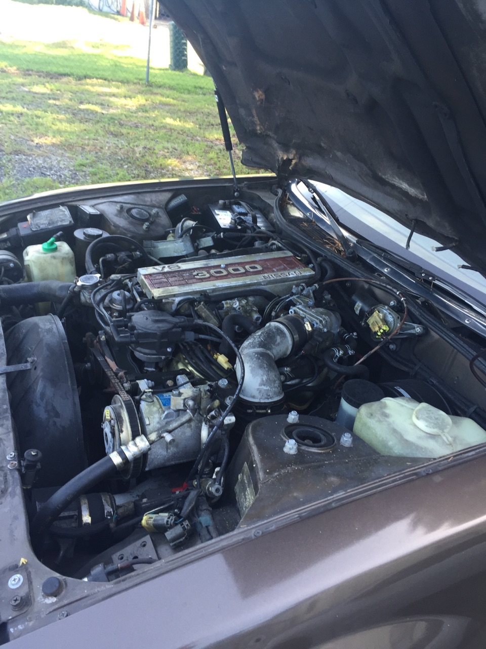

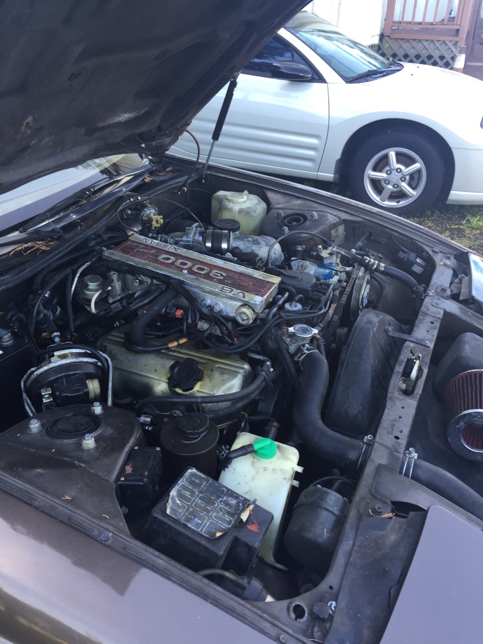

Does the engine bay look ok? Does there look like there was a fire?

Get it, if it's cheap enough. It's just money.
I don't see any fire signs.
