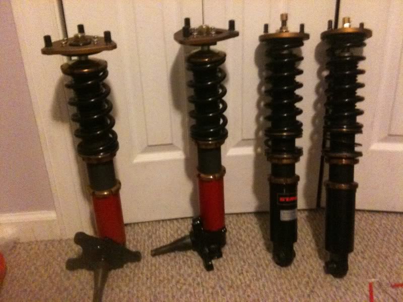

Yes I have them. Great brand for the money. Are you talking about the s13 rear subframe swap?

Id say no
Every coil over I have seen required cutting and welding, because the final product has to resemble this pic, so you either need a donor to hack up, or use your current parts and send them in, or have a local shop do the welding. When you see pics that just look like normal coilovers, then theres still a lot to do.
