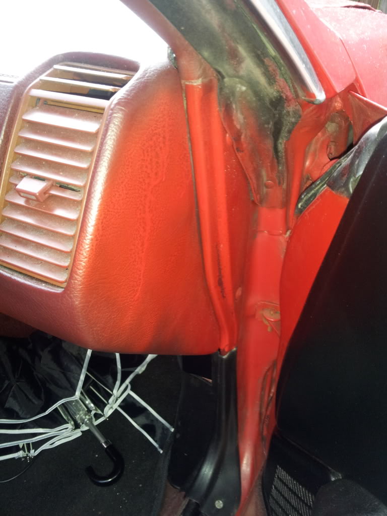

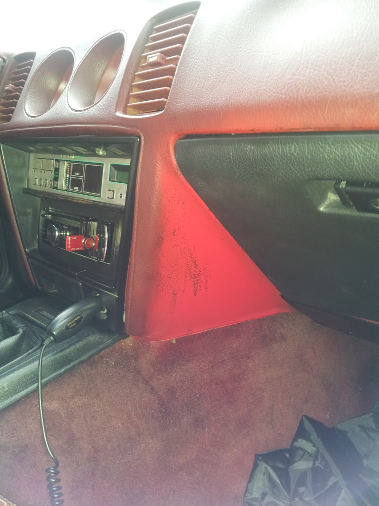

Yeah, I went ahead and sprayed the door panels black just to see how it would look. It definitely looks way better than how it was. I forgot to take pics of them before, but when I got the car, whoever repainted it red (it was maroon with maroon interior) tried to paint some of the interior red too and did a horrible job at it.
Here are some pics I just took of some of the interior I haven't replaced or did anything about yet...
That is how the whole door panel looked on both ends. They were complete eye sores and I had had enough. You can see a little of the door after the repaint in the second picture.
They looked way better but like mentioned before, chipped off easily. So I plan to sand them down (meaning not just my new paint but getting all the red paint off as well ) and then putting a couple coats of primer and then a couple coats of the paint on and see how that works.

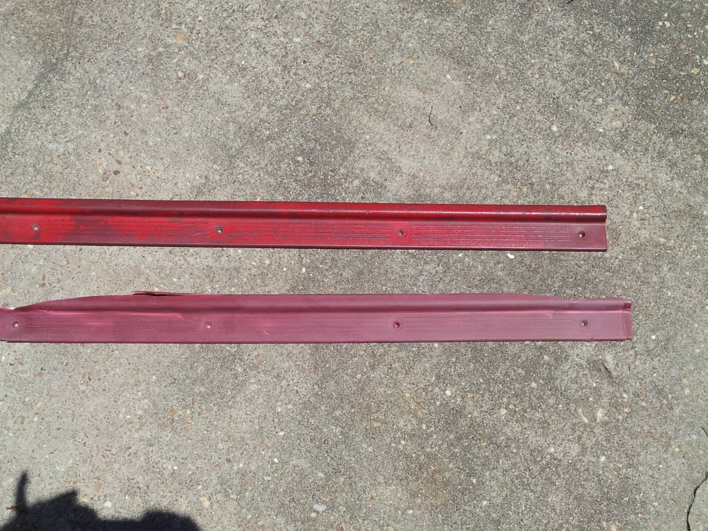

I did that with the door sills
The one on the top is how they both looked before (and how the door panels looked before) and the one on bottom is after I scrubbed the red paint off.

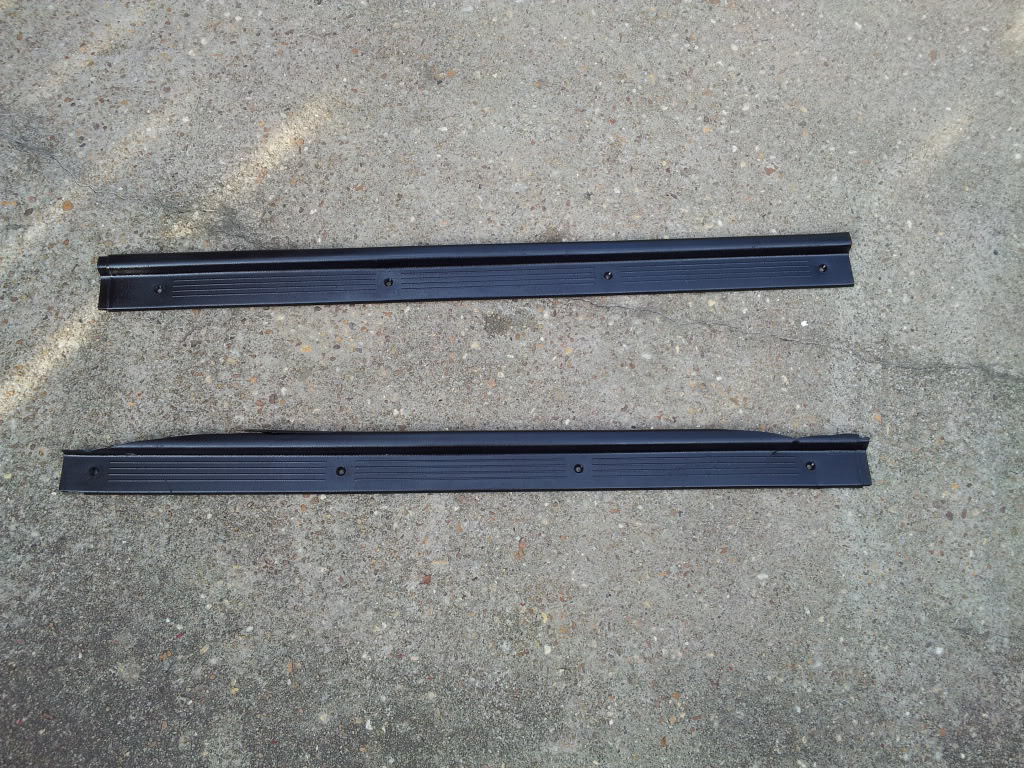

Here they both are after sanding, two coats of primer, and two coats of gloss auto interior paint.
They get a pretty good bit of action, it was a few weeks ago when I did that, and they still look new! (Aside from the broken one that will obviously need replacing at some point)
