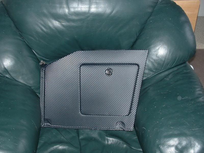

All I did was re-skin mine using carbon fiber vinyl cloth and some leather. Here is a picture of it. Was strait forward and fairly easy. I got the material from Metro Restyling. Cost like $50 for both doors.
Test fit with my old arm rest. I got a black one to put there.

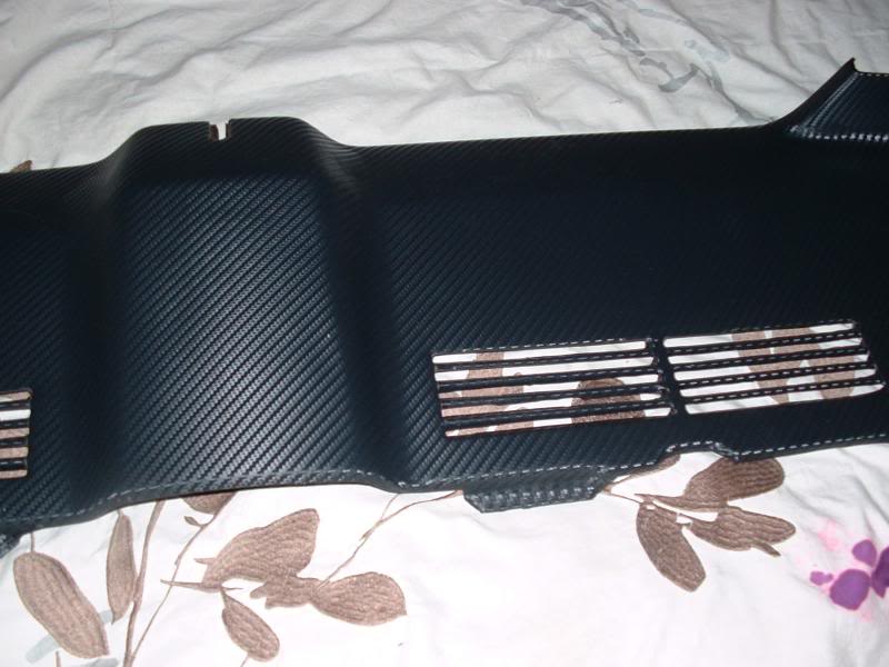

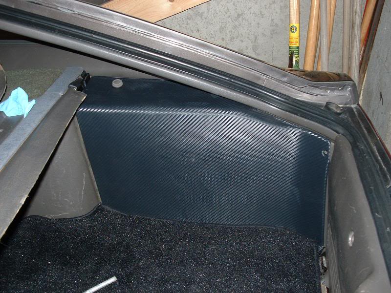

Doing over most of the interior with stretchable 3M di-noc carbon fiber vinyl. This stuff comes in all colors and textures, and with the air channels underneath, it is easy to apply and get ALL the air bubbles out. Not that expensive either. With a hair dryer, you can stretch this stuff over a exterior mirror with no seams. Enabled me to restore my own 308K mile 32 year old interior for approx. $300 and also 40 - 50 hours of my labor. The alternative was to buy a take off interior that was 30 years old with its own defects. And this stuff can be pulled off and it does not destroy the original part. Haven't tackled the rear shock tower trim yet. They will probably be the last pieces I do so I can learn as much as I can on applying this stuff before attempting such a complex shape.
The very first thing I did in carbon fiber 6 years ago was the radio and heater/AC dash panels. I used real 2mm thick Carbon Fiber sheets. It was easy enough to fabricate and looked good enough that I decided to use the rest of what I had to do console inserts, including around the mirror adjusters and shock control area. Cost me around $30

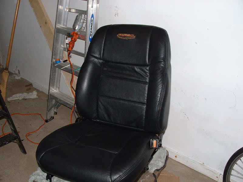

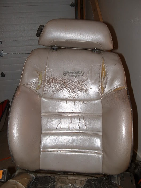

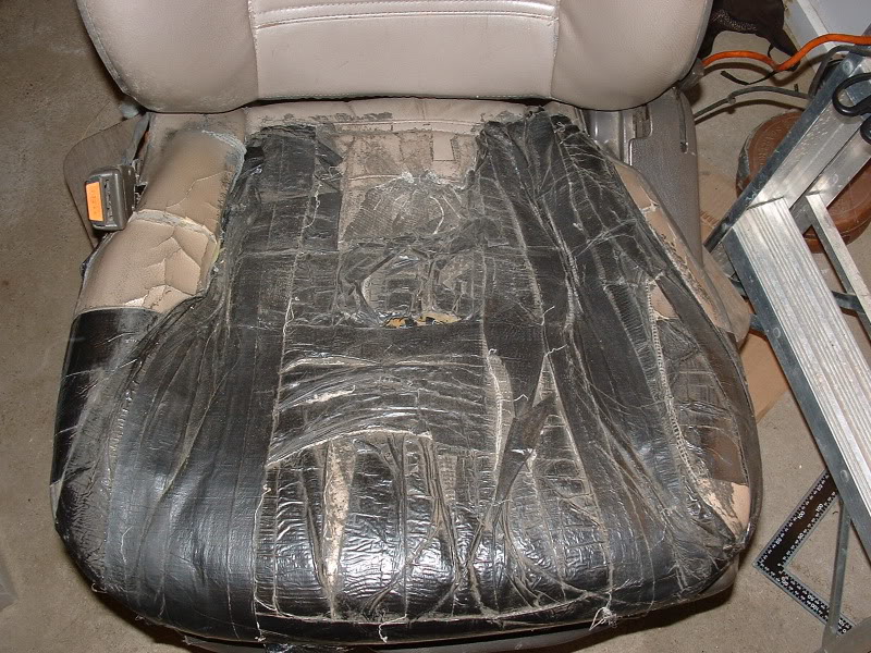

Then I took out the seats, and redid those in black leather myself, and again, it was strait forward and fairly easy to reskin the seats. Cost me $375 for all leather custom seat skins.
Before:
