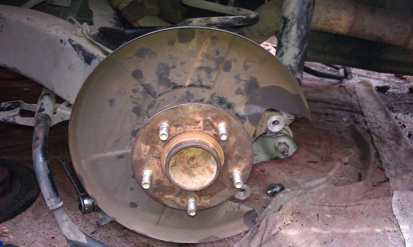

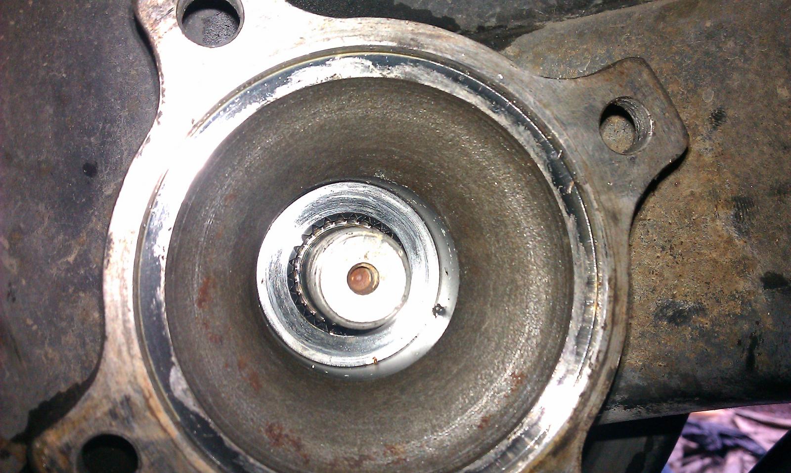

The front wheels were pretty straight forward the but rears ones are completely different. ive gotten the axle shaft off my parts car and removed the big 30mm nut in the back of the hub but it just wont budge. i dont know what to do from here. here are some pictures to show where im at. thanks in advance.

You may have to press them out. But they will come out.
I'll try to pry it out. Thanks

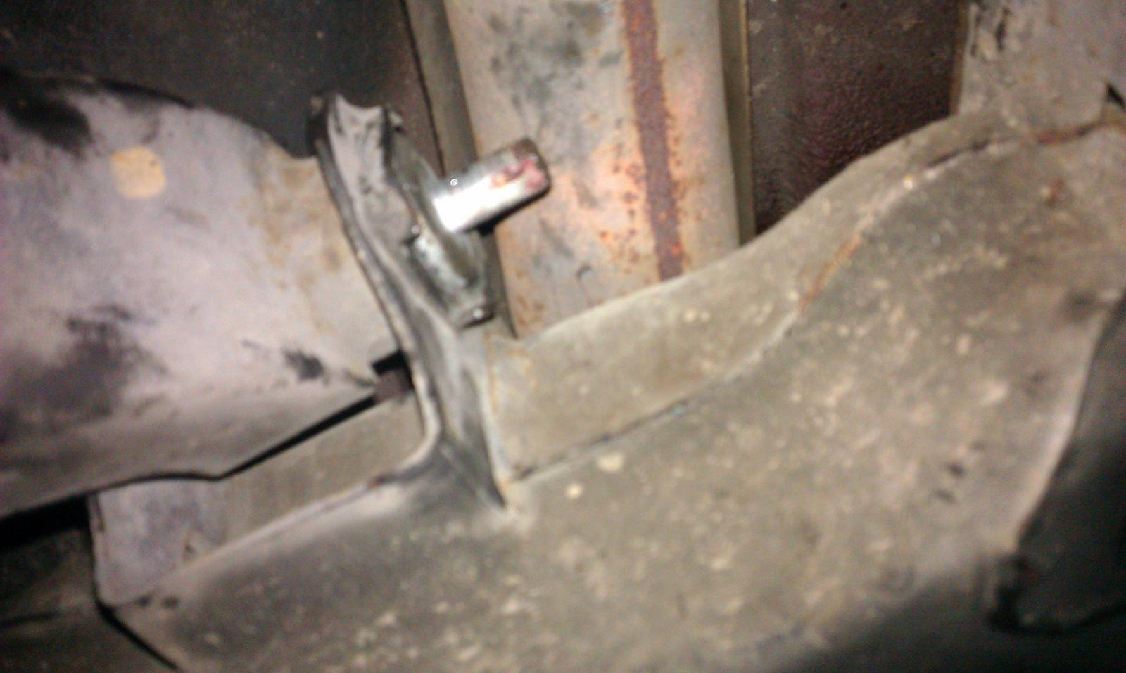

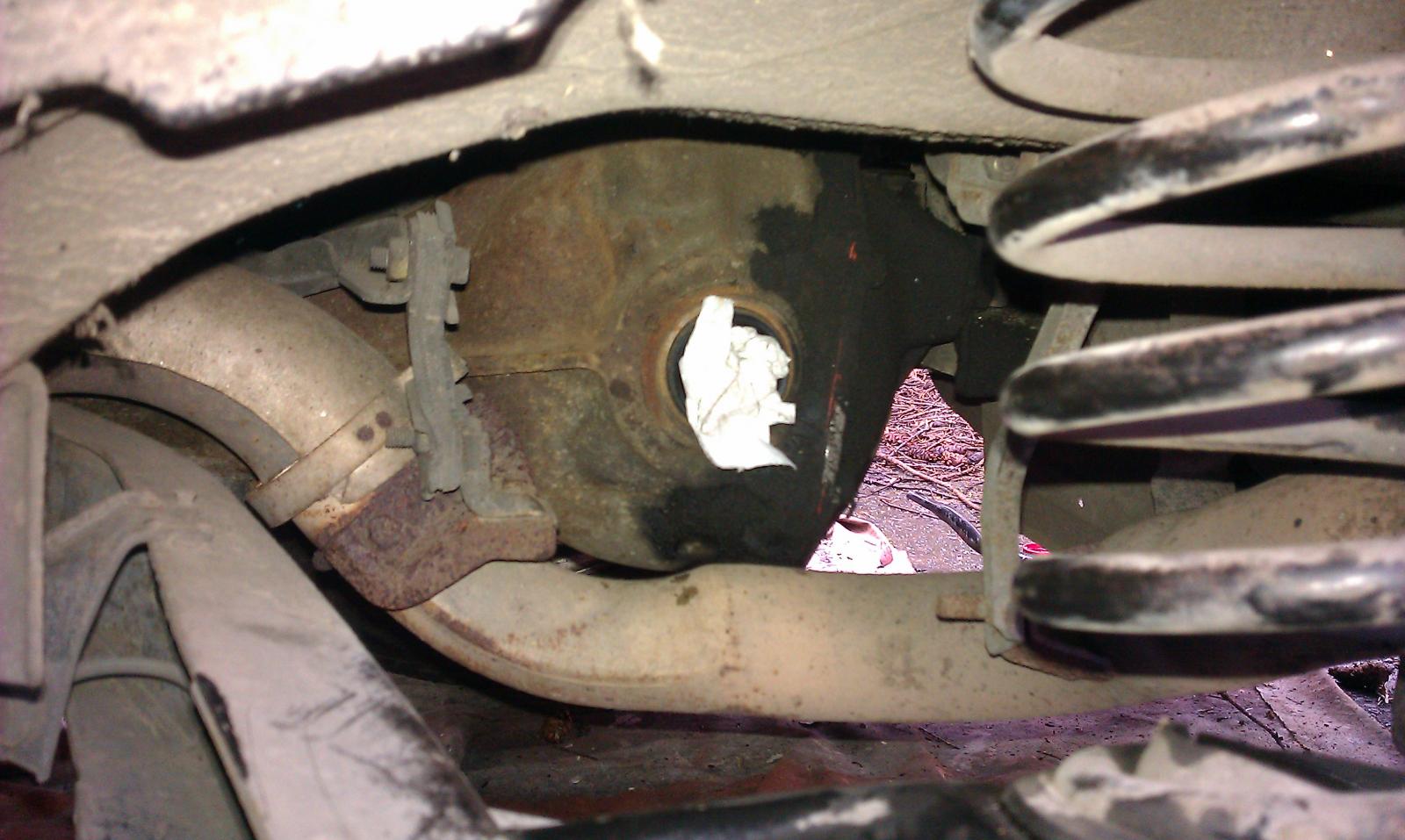

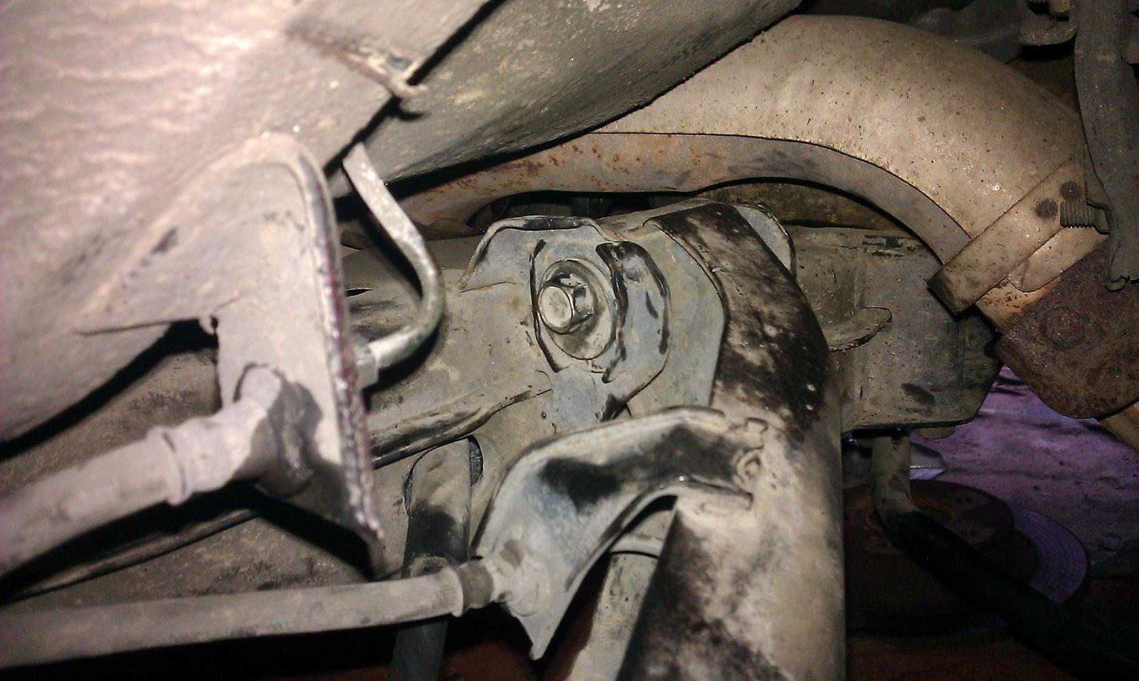

so i couldnt get the hub off so i decided to try to take the whole control arm instead. unfortunately the inside bolt of the control arm will not come out. the other 2 came out just fine. i thought that i somehow striped the bolt till i got to the other side and came across the same problem. the bolt seems to have a different thread pattern than the other 2 bolts. seems that 3/4 of the bolt is threaded while the bottom side of the bolt is flat. it wont budge or move when i try to punch it out like the other bolts. here are some pics. any help please? thanks

i tried searching some more info on the web and found this post of another person have the exact same problem that im having. http://z31.com/phpBB3/viewtopic.php?f=6&t=1139&start=0 just in case if i wasnt descriptive enough.

Probably the same issue. Parts have fused together with rust. Get a bigger hammer.

order a can of kroil. Its the stronger version of pb blaster we use it at work it penetrates rusted parts up into 1thousands of an inch.

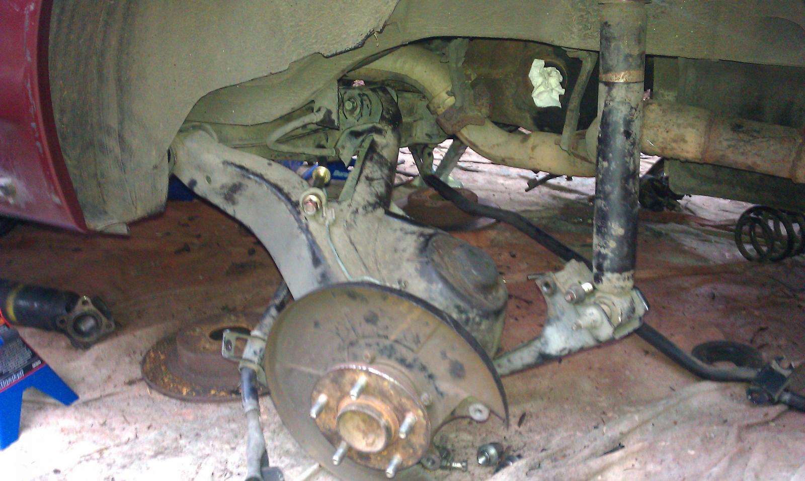

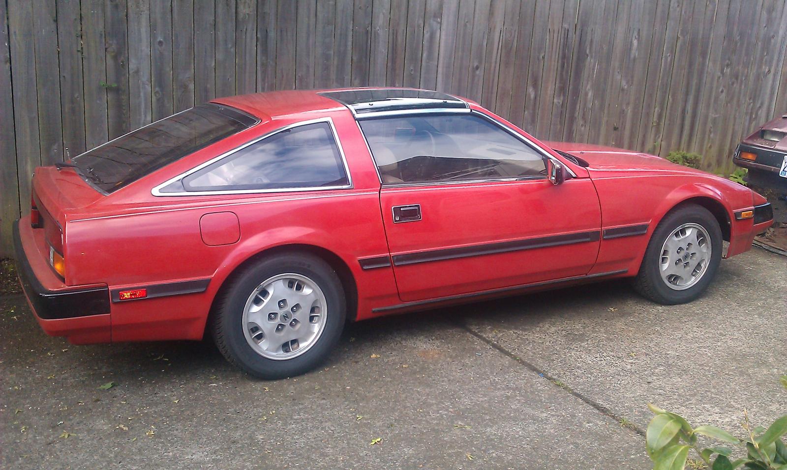

Finally finished last week end. Here are the before and after pictures! I also installed all new poly bushings!

I forgot to mention that I also swaped in the turbo half shafts new brakes and rotors. I think the whole process from removing and installing everything took me about 24 hours of work.
