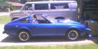

yo zach why blue? who would paint thier car blue
looking good. what kind of mpg do u think ur gonna get with it????

Probably the same shitty MPG I got with my last engine lol. Standard mpg for a car that size, maybe better since it's a small car (Then again I drive the thing hard). So I'm guessing anywhere from 15-20mpg depending how I drive lol ><
PS... NICE z man lol

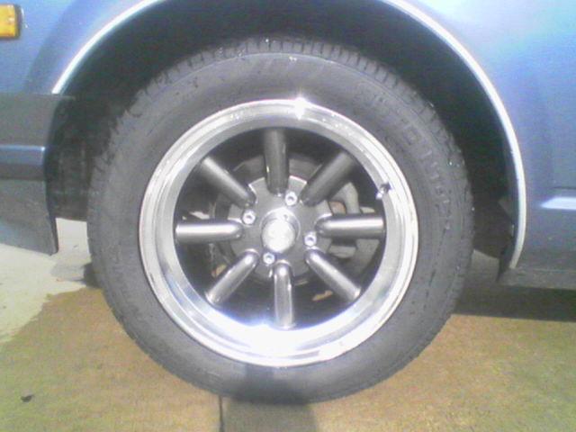

i just realized, are u rolling on these too? 16?

yeah hes got 16's i think me gonnabe swapping out to my rack and peanut setup. cheaper than the custom header my brother can make. then he gets to use the nice jet coated header from jtr.
