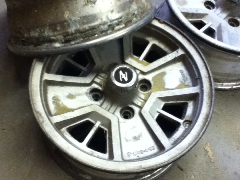

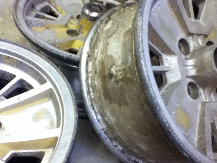

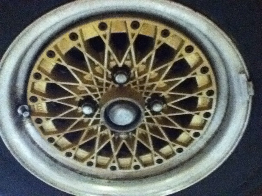

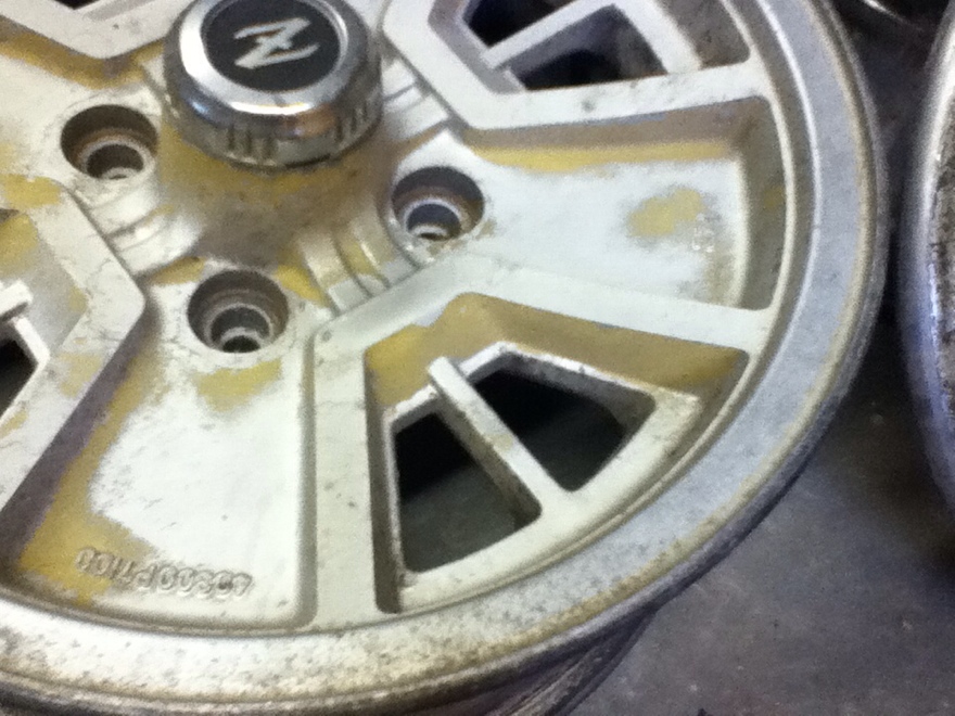

i have some i think called iron cross rims im wanting to restor them they look like birds carped all over them ten years ago and looks like someone tried to paint over them. i dont want to damage them so im wondering if you guys have done this? im about to post some pictures
Old Jun 24, 2012 | 12:36 PM
Male's Avatar
Joined: Jun 2012
Posts: 245
From: Kansas

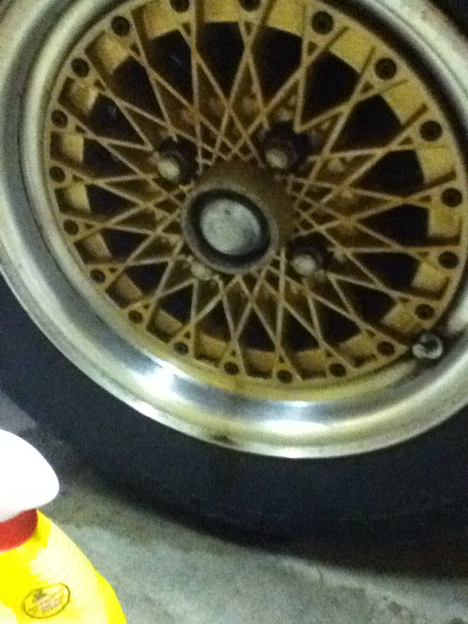

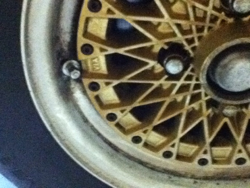

o and i was wondering how to take of the black buld up it looks like on the enkies

Personally I'd take them to a powder shop have them blasted and powdered in what ever color u want. Course I'm a lil bias cuz that's what i do. But as long as u keep them waxed there far easier to clean then chrome and it dosent chip like paint dose.
You can get one of those polish ***** put it an a drill and go to town with some compund.
Old Jun 24, 2012 | 02:56 PM
vg30_s12's Avatar
Joined: Jan 2012
Posts: 55
From: under my s12, s130, yo mama bed...
Well, if you want to just clean them up, some good wheel cleaner, brushes, rags"fake"steel wool and **** tons of elbow grease should take care of them... * If they not clean up, figure out what metal they are (steel, aluminum, or rarely magnesium) are they painted or clear coated(which you said someone did) assuming they are aluminum, *strip the paint with paint stripper ( kleen-strip works good, use gloves and don't leave it on too long, gnarly stuff will turn your lungs and skin to goo) after all the paint its stripped, clean and dry it, ether sand with 220 and high build primer/paint, or sand with 220,320,400,600,800,1000 anne of further if you like, then polish with mothers mag polish to mirror shine... I just finished a set verry similar to the mesh wheels you posted and in similar condition. Turned out awesome

Oh and the mesh wheels I there nice its just that black stuff I can't get of I trie like every cleaner
Old Jun 25, 2012 | 01:16 PM
Male's Avatar
Joined: Jun 2012
Posts: 245
From: Kansas
Aroun the lip

ok so i used this think called goof off i found at wallmart with some grade 3 steel wool with some elbow greese and managed to take off lots of thank black build up on the enkie mesh weels and im thinking of using the aircraft remover on my wheels do you think they will damage them it looks like hard core stuff

on the datsun crosses

Honestly that spray stuff is junk, use the goo stuff in a can, can be found at walmart paint section... Copper looking can by kleen-strip...
Ether one I repeat, be very careful... The spray will away your lungs and the gel will burn your skin right off the bone if you let it... But is the best way to get the paint off
Grab a paint brush (real hair recommended) pour some in to anothe clean metal container like a soup can... Brush on good(kinda thick, but not over doing) wait 15-30 min, you'll see the paint literally lift off of the aluminum, grab a plastic scraper of some sort and strach off remaining paint. rinse of throughly with hose(pressure is good) dry and repeat as needed...

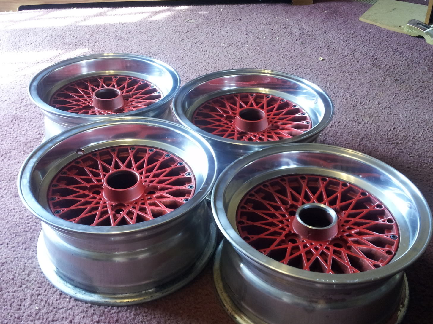

***** and giggles, here's my wheels

Well what do you do with the rims now that the clearcoat is removed?
Old Jun 25, 2012 | 10:16 PM
From: Victoria, BC
Bead blast then polish the protruding surface with a cotton buffing wheel (sorta "A" shaped on this wheel). Mask and paint the rest of the wheel with an engine enamel - satin black or whatever.

Yes, they are aluminum. Bead blasting is the same as sand blasting but with a special media that's made of glass "beads" that will not damage the material like a sand blaster.

You'd have take it to a sandblaster... not worth it imo unless you really like stock wheels, just clean, sandand polish or paint as need, it doesn't look like you have much lip so id say paint em... I used plastidip fwiw... Good stuff
I say goo over spray because its hard to get good coverage, doesn't stick on very will and very easy to breath it... Every time I've ever used it I had breathing problems...
Ntm they cost about the same but the kleenstrip will last longer if you use it right...
