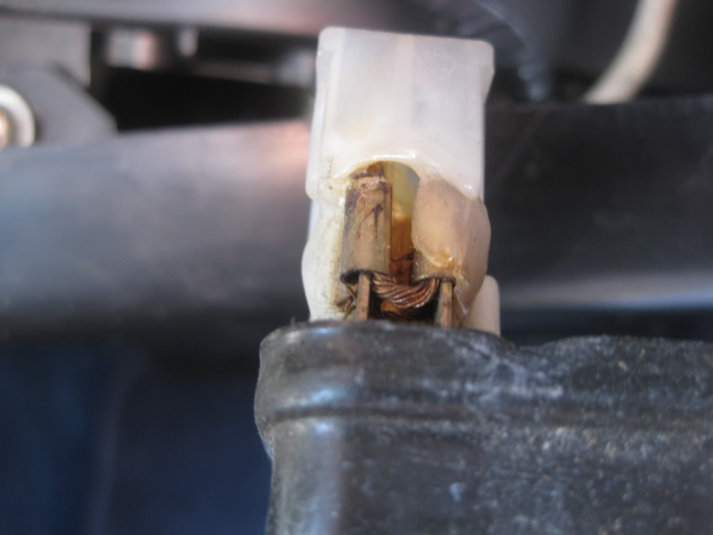

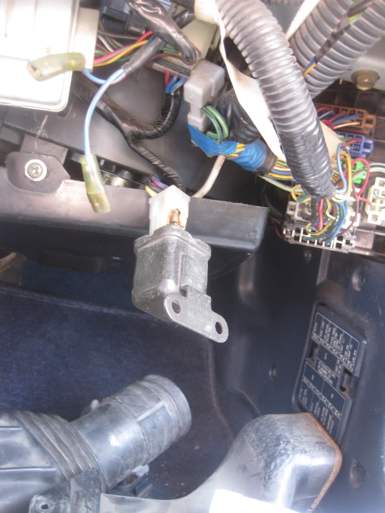

Does anyone know what this relay would be for? It is loose on the passenger side of the car. It looks like the relay may have died or someone got lazy with fixing a wiring problem because two of the connections are jumped.
I haven't gone through the FSM to figure out what it is for, but I'm sure someone here would know.
If this pictures are too big let me know and I will fix it...

It looks like the fuel pump relay to me. It should be mounted on the inside of the wheel well behind the glove box.

Could be, but there are 3 relays against the wheel well, 1 green and two black ones. Green I would assume is for the fuel pump, same as the two in the engine bay?

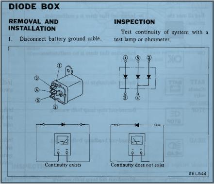

Just checked the FSM and it appears that it may be the Diode Box?
Anyone know what the diode box is for and if this is indeed what I'm looking at, why it would be jumped?
EDIT:
On a second check I doubt it is the diode box, as far as I can tell it should be under the passenger side door sill.
