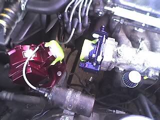

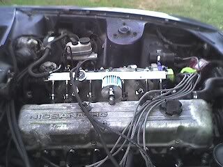

My part's Just came in Saterday. Been Waiting since May25th for them. Now they installed with out a Problem. No gas leaks or nothin. Pressure got built up to 40 PSI. The spacer only came with three bolts. But no worryes. I am just glad I finaly got the part's. For the 240SX T/B what did you use as a air duct? And i am having a fre problems trying to set up a linkage useing the stock stuff. any tips on that would help. Here's two pic's!

find the AFM to turbo stock hose from a turbo car. Use part of it. Cut it. It is a larger dimeter and has ports for your valve cover vent... oh wait...
if you dont' need any hoses to plug into it, then just use a 45 deg plastic pipe bend and two couplers.

While the site was down. i got out side and really got to work on it. I used the Air filter box to AFM hose. since it's 60mm on both ends. cut it to lenght. a lil elbo gresse. and i got it on. throtle linkage i got worked out as well. I tryed to start my car as well. She spuderd but that's about it. but at least it tryed. so i know it can be capable os runin.
