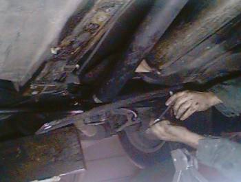

is it that flat crossmember that goes under the driveshaft just in front of the diff?
ya you need that. its like a lower strut brace kinda thing. I'll help stiffen the frame. I can pull one from my parts car but probably not this weekend. I guess I'll have to see if I'm ready to pull the suspension... hmmm...

Thats the one. Is it safe to drive without it just till I get another one? I can go to a local yard and get one, but I cant drive with it as it sits now as its still bolted on but hangs way to low.
Old Oct 22, 2005 | 11:46 AM
ya I think the car would be fine to drive without it. Just don't do any autocross type driving.

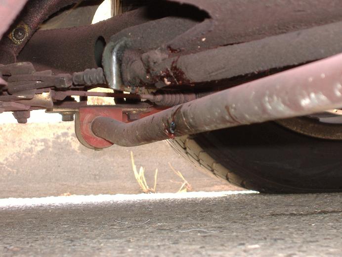

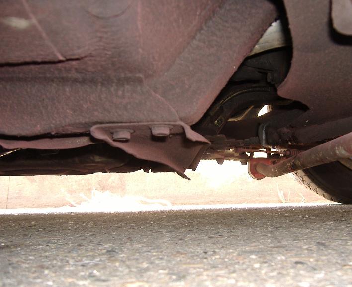

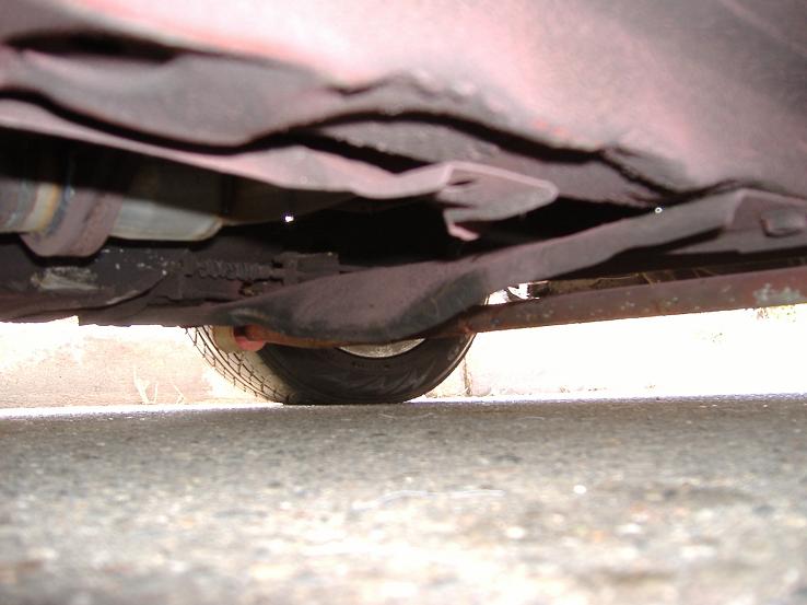

Made a trip to closest yard with no luck. I would have made the 30 mile odd trip to the next one, but my stomach wasnt have'n it. I was f*cken hungry. So with that in mind I took a look under there to check it all out in the daylight and low an behold . . .meat!!
For now I'll probably hammer it out and then grab one later.
