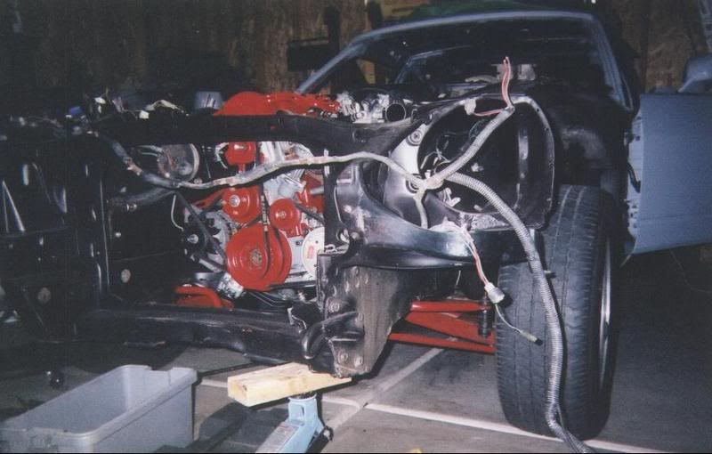

Old Feb 23, 2007 | 04:48 PM
Here's what I got at the moment:

Ok so... No A/C you guys think it is possible to put the Altenator in its place with the MSA adjuster?

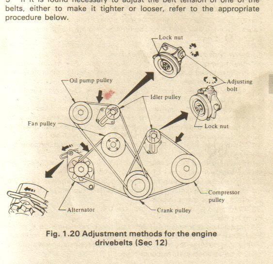

plus with an electric water pump you wont' have a pully there to pull against. You can use the AC's adjuster pully to tighten the belt on the alt. All you need to do then is do a fixed mounting of the alternator on the other side. You only have to worry about the forward to back positioning to line it up with the AC pully position...
You can mount it over there, but the mounting plate will be totally different. You should make it from a couple pieces of plate steel.
