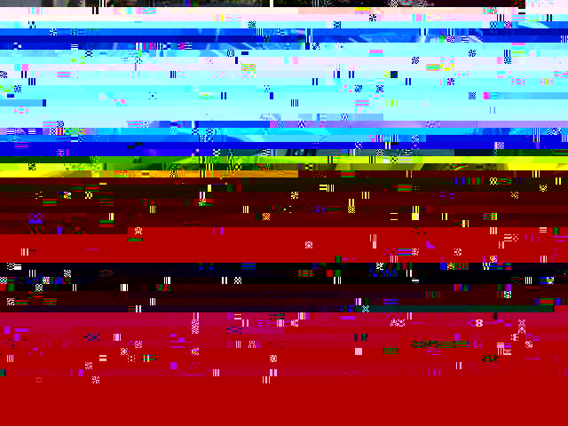

Well I am officially off vacation for the next month then I am off to London for 2 weeks. These vacations are putting real big dents in the time I wanted to have my car done by. Any who, This is the majority of the body work that was done, It took only one day and there is still some left but the fenders look alot better in my opinion. Also I am going to paint the car Cadillac Escalade Pearl White, any input on that?? THX, enjoy the pics.

Well I actually ran into some problems with the hatch, it had a little rust on it and I couldnt weld the holes the metal just kept burning so I just had to use body filler.{which I was trying to avoid} and the fenders were pretty straight I just welded a plate where the turn signal was and gave it to my budy to sand and primer. oh and wildman It depends on what you want, I am still learning right now and barely trust myself doing bodywork.

What welder were you using at what settings and what size wire?
Sheet metal on these cars is very fragile and doesn't tolerate heat very well as you've discovered.
Use the lowest amperage setting on your welder with the thinnest wire you can.
