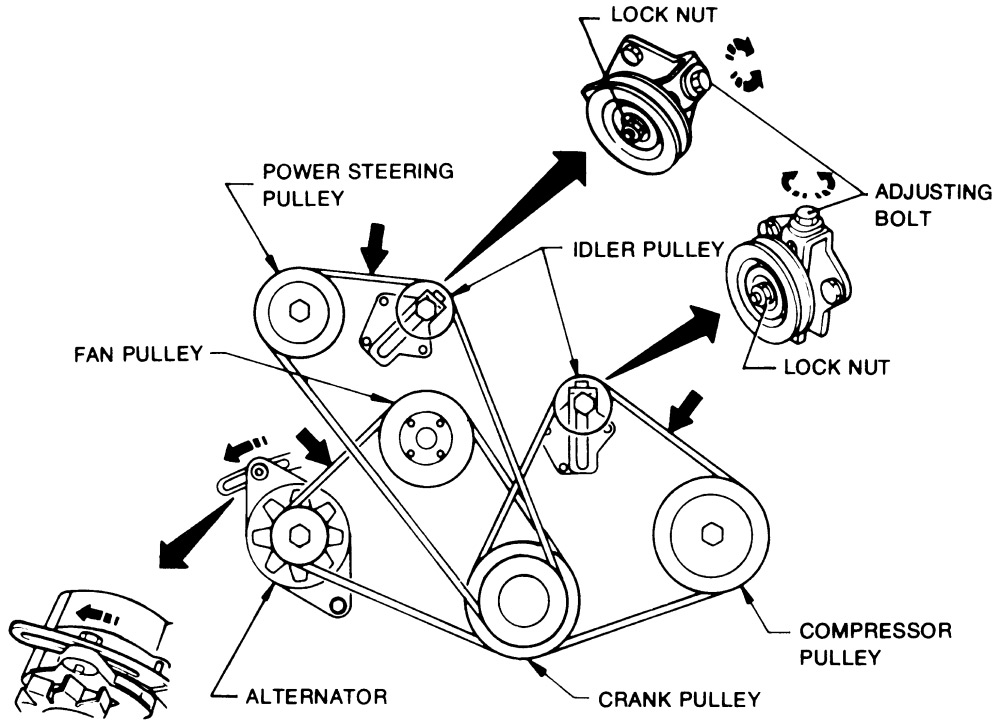

thxone Mar 19, 2008 12:27 AM
2 Attachment(s)
Actually Jmmorriso, it depends on the length of the belt between pulleys, the type of belt and how much force is applied to find the deflection amount. I didn't realize which belt he was talking about until I re-read the post but if you want exact figures for the Alt belt from 1970-83 is no more than .44in (1.1cm) at the middle of the longest span or accessible span with 22lbs, (10kg) or (9Nm) of force applied with the thumb. Your Welcome :)
Attachment 6764
Attachment 6765
