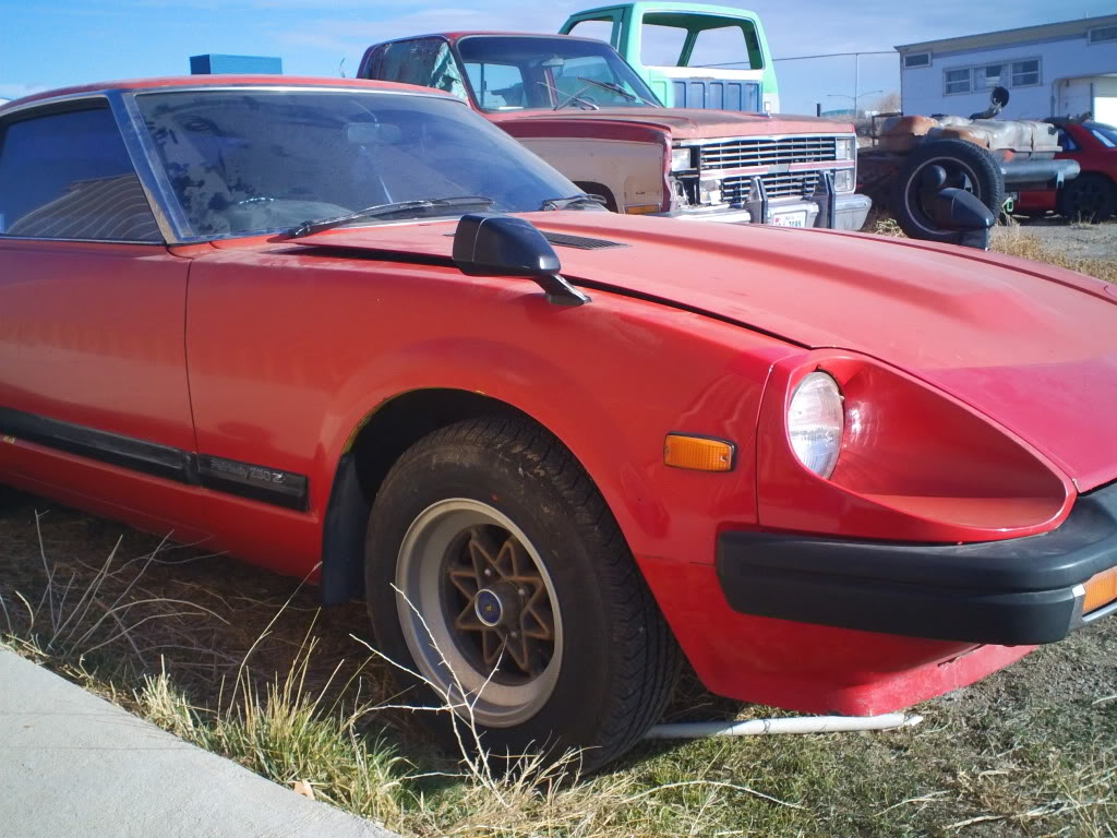

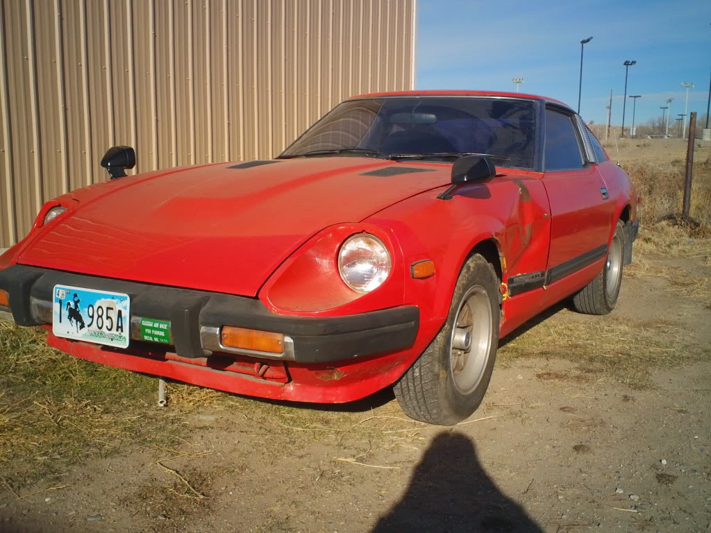

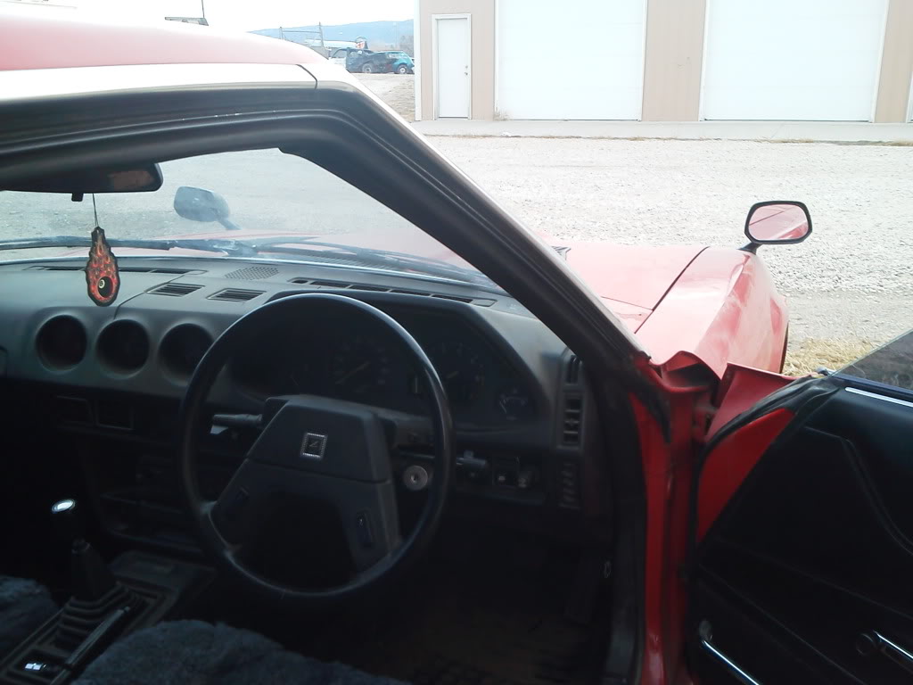

here are some pics

here are some pics

and gixxert, good for you rhd is f****** amazing lol

Where are you located? Perhaps some one close to you can help you out. I would love to get a hold of a rhd...
