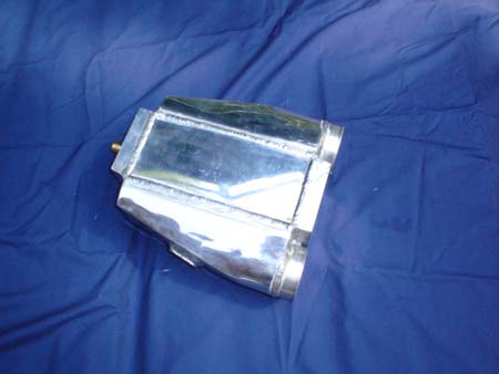

has anyone really used a Air Water intercooler, thats the set up i plan on going w/ for my Z when i go Turbo... instead of a Air to Air set up.... i hear alot of good things about the set up...

Well i know how they work just wondering if anyone has used them. i was planning on running it right where the stock airbox is. It uses it's own water circulation and a mini radiator set up. you can also put Ice inside of the water box for 1/4 mile, dyno run applications

I know of several guys that drag around my area, that run air-to-liquid 'coolers. One particular Honda [Grey Civic Hatch, you might've seen it run, Nismo] runs a 70/30 mix of alcohol and water in his box, and packs dry ice around it and the intake piping just before a run. Works wonders on a 20psi twin-cam Honda.
