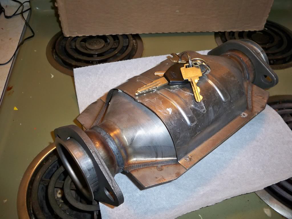

And as for the catalytic converter, if you follow the pipe from your headers, down, out of the engine bay, back towards the muffler, you should see something like this, about midway through your chassis:

I had the same smoke problem you said you did, except i got tons of smoke in my cabin. Which was due to a straight pipe that ended halfway to the back of my car, and i didnt have any flooring so all the smoke that came from the oil the turbo was burning got in my car. First day i bought her, on my way home from paying for her, it started raining xD
Carbon Monoxide Poisoning ftl.
