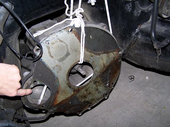

yup there is a plate..ill go take a pic of it in the garage...it goes between the engine and the tranny...seals everything so no ROCKS!!! can fly in your flywheel!!!! ahaha

like this....

i duno tho did they come in auto's? probably thats pretty open!
and yes im holding up my tranny with a piece of rope...!

no problems, the plate goes onto the engine...THEN you put the flywheel on if i remember correctly...i havent done it in a while..hehehe
yeah it does....they probably forgot it and didnt wanna take the **** off to put it on, or didnt have one at all?
when i was going clutch on my brothers 300 I put everything on, torqued it, and saw this plate laying there...then i realised i forgot to put the damn plate on...so i had to take the flywheel and pressure plate and all that off to put the damn cover on...

As far as the auto's go, yes, they definitely had the plate there to seal up the trans.
