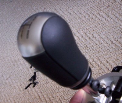

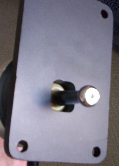

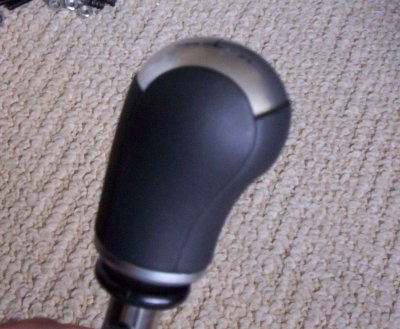

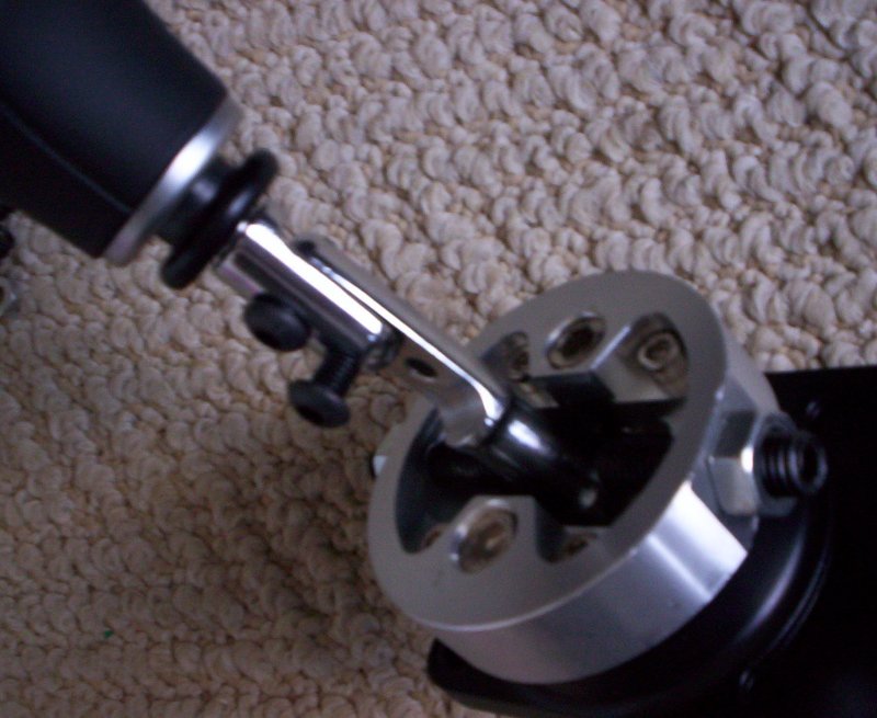

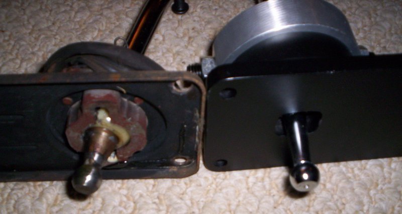

So I bought the cheapo shifter.
It has adjustable shifting stops as well as the bottom plate that has a square opening in it allowing the shifter to only go so far.
I also bought a 2008 Mustang GT shifter knob to go with it. Its leather and silver. I like it. :023:
The shifter itself has three holes so you can install this funky backwards angle piece like the Mustang requires. I'm going to cut the top mounting hole off so I can mount the shifter knob another 1/2 inch lower.
http://www.bleachgarage.com/temp/shifter01.jpghttp://www.bleachgarage.com/temp/shifter06.jpg
http://www.bleachgarage.com/temp/shifter02.jpghttp://www.bleachgarage.com/temp/shifter03.jpg
http://www.bleachgarage.com/temp/shifter04.jpg
http://www.bleachgarage.com/temp/shifter05.jpg

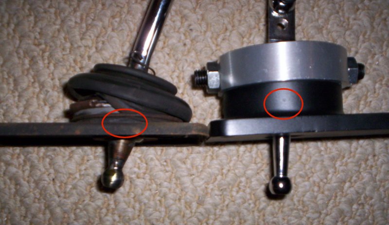

Bleach Sep 29, 2008 07:18 PM
it does appear that the pivot point is a little higher up.
Overall, before cutting anything, even the shifter handle itself is lower. I'll drive it first before I cut anything

Bleach Sep 29, 2008 10:53 PM
It drives really nice. The shifting is a lot shorter than stock. I don't think I will cut it down any more.

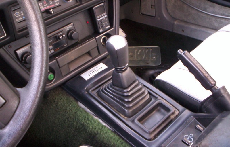

Bleach Sep 30, 2008 05:03 PM
Faded green carpet and accordian rubber boot meets new short shifter.
http://www.bleachgarage.com/temp/shifter10.jpg
http://www.bleachgarage.com/temp/shifter11.jpg
lifegrddude Sep 30, 2008 07:16 PM
Looks good dude! I may have to pick one up down the road for sure.
