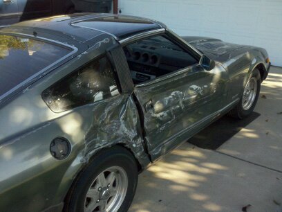

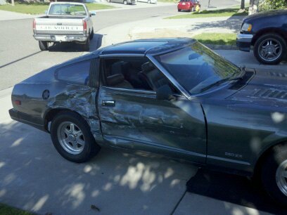

Ok so I’ve been spending allot of time effort getting my 83 280zx none turbo t-top 5speed in good working condition, I finally get to that point getting her all dialed in and start making plans for the future. And then my girl goes and does this to her!!!!! I’m thinking she got jealous and wanted her out of the way hahahahha no jk but that would never happen..(Me getting rid of the Z that is ) So i've been on a search to find a new to me ride, a decent start and wanted to know from all you experience zedsters the range of yrs I can go to use my car as a parts car for the new lady. Differences in models, L28 to L28e, auto to 5 speed swap difficulties ect, ect down the line. Not much in my area wouldn’t mind going to a 2+2 for the extra seats but don’t really care for the look of them. As far as slick top there’s no differences right? Besides the obvious wiring changes?? Have found a couple of 300z and a 240 but really love the 280 plus I have all the extra parts all ready. Any thought’s, comments, advise or otherwise would be greatly appreciated. Thank you
Attached Thumbnails Nightmare my gf wreaked my lady!!!!-straight-.jpg   Nightmare my gf wreaked my lady!!!!-bck.jpg   Nightmare my gf wreaked my lady!!!!-fwd.jpg

Aww man that sucks! What did she do, to get it like that? And I think you should try and get it fixed. Is that the only damage? Is the frame still straight?
Old Nov 16, 2010 | 07:04 AM
man that is easy to fix that, a door and a quarter panel. i guessing by your post and small amount of damage your gf is fine.
Old Nov 16, 2010 | 08:37 AM
Looks totaled. Those rear panels are a pain to fix.
Keep that car and make it her daily driver. She'll never forget (dont' fix the door or leaky roof for her) muahaha!

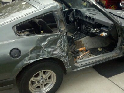

So does anyone have any Idea about: 1 being able to get the door pillar straight enough to have a new door work properly, 2. the replacement rear quarter panel from black dragon? Is it an overlay or a weld in?
I will post more pics tomorrow with that pass door open and door pillar and rq panel.

Um Looking at it. its kinda a goner. Its had to have buckled the frame. and even if you fix manage to fix it theframe structure is compromised so it will never be as good as it was.

Yea blue your right the body did buckle at three places. Just above the roof line next to the t-top, just under the door latch pin, and inside just below the quarter window bout 4” from the door frame. If I can get it all straighten out. it will never be as good as new and if I was to get into another wreak one being worse then this or at any type of real speed the body being compromised on that side would be the weakest point and would go first no matter where the impact started, as far as cabin buckle that is.
Good thing is that the underside frame and axle is ok. I straighten out the wheel well and got it off the tire and had clearance for any bounce, bunggied on the door to keep it from popping open and took her out for a good drive both low and high speeds I had no dog legging (had a friend following) handled well even hitting corners both sides seemed to respond as normal. So I think I’m going to try to repair the damage and see how well I can get er done. will post more pic's tomorrow after I bang on her some more.

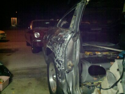

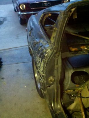

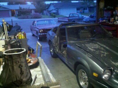

ok so I’ve made some progress, her shape is starting to come back but still got allot of work to do to get her straightened out properly, but I believe that with some time ill be able to get her pretty close and have to finish off with some bondo. starting to wish I had taking the time to learn the old fashion way to do body work when I had the chance but I was to young and impatient at the time, that guy has now past and don’t think there is anyone that still knows how. I know I don’t know anyone that does. So here’s some pics of how she’s coming. The first shot is before I started on the body wrk just got everything outa the way and the smahed door off and gutted.
Got a call back from the guy with the 2+2 countered with 600 might do it just to have another. Drive it for awhile and make some money. She is all there and has been sitting for nine yrs. When I looked at it seems to be in pretty good condition even still has the stock lovers on it. Said that the owner had just parked it and bought his wife a new car instead of dealing with some miner issues. Jumped it and the motor turned over first try, didn’t start of course the gas has long turned. Have him checking to see if they had taking care of the non op or if it’s off dmvs books

If you know how to spot and braze weld. you can drill out that quarter panel and order a new one from black Dragon. and I "Think" you might be able to order the part where the latch bolts to from Nissan themselves. as for where the door hinges go. I really have no clue. you might be able to order that panel but it might be a pain to change.
Yes I can do both as well as ark, mig and tig. Although I don’t have the equipment here at home I, do have ark but running a stick is way to hot for sheet metal. I could barrow or rent them though. From what I can tell from reading the black dragon is there rq panel is just the outer skin and more then likly as for repop panels go are a whole lot thinner gauge then factory. So I could do that rather then slapping bondo on to make it look clean again, after I get the interior walls back in place. To be able to get that done need the force and strength of the outer skins to remain intact so they move together. I will look into Nissan for the door pillar that would make completion and proper alignment easier as well as the door seals to sit straight, thanks for that info. And luckily the front qp and pillar are fine other then a small dent line at the bottom of it if that was gone too I would go ahead and part this one out for another that would be just to much damage to bother with. Thanks guys back to banging, keep ya posted, later.
