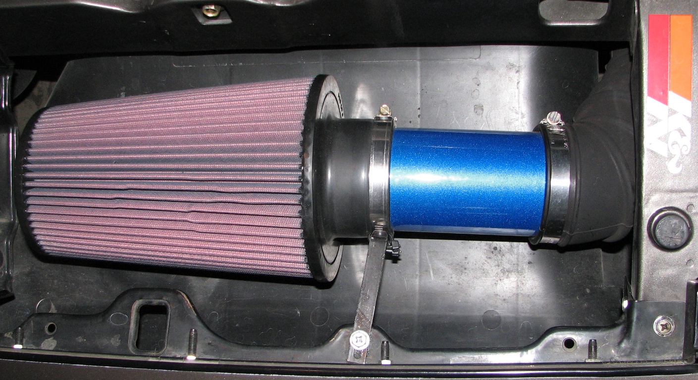

I'm am using http://www.thezstore.com/page/TZS/PROD/PFFC13/11-2934, they have one for your model, http://www.thezstore.com/page/TZS/PROD/PFFC12/11-2922
Gives the car a little more growl when you go through the gears. And I guess I picked up a 2 Mpg increase in mileage.
Here's a few pics of my install, I later added a small bracket to hold it in place.
Attached Thumbnails aftermarket air intake questions-zcar-filter.jpg   aftermarket air intake questions-filter-bracket.jpg
