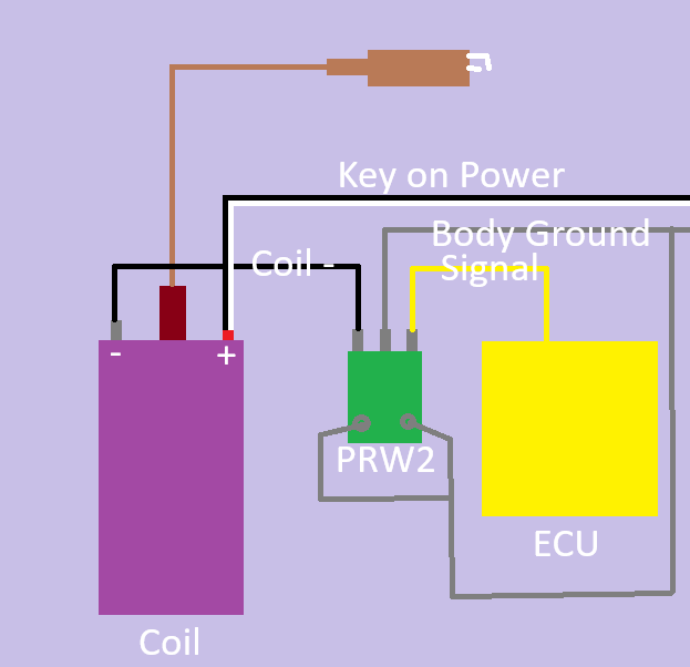

I replaced the coil, but the original coil that came with it still functions fine. I have power at Black w/ White Stripe wire next to coil. The yellow wire in that bundle has 12v with key on, blue wire seems to be nothing. I believe the Power transistor is busted, which would have a blue wire coming out of it with a bullet connector. This wire is missing. ECU has a green light that comes on with key on, turns off when cranking, and quickly comes back when cranking stops. I hear clicking whenever the distributor spins to the next firing position. I currently have a PRW-2 in place, middle pin connected to ground, one pin connected to yellow wire, one pin connected to coil negative(per that one PRW2 image floating around). I did swap yellow and coil negative on PRW-2 just in case I got it backward. If I tap yellow wire with jumper, I get spark.
I hooked a digital oscilloscope to yellow wire and saw high pull with key on, low pull with key off, but the pull didn't appear to change when spinning distributor. I don't know how to read an oscilloscope, but I was able to zoom in on the wave and it just looked like noise really.
Here is a rough drawing of current wiring.
If I break the signal wire manually, I get great spark. It just seems the ECU isn't tell it to ground the signal, allowing the coil to respark. I did remove the ECU and opened it up, did not see any burn marks or anything to indicate it should be bad. I tried the GM HEI module in place of the PRW2, but it didn't seem to do anything at all, less than the PRW2.
