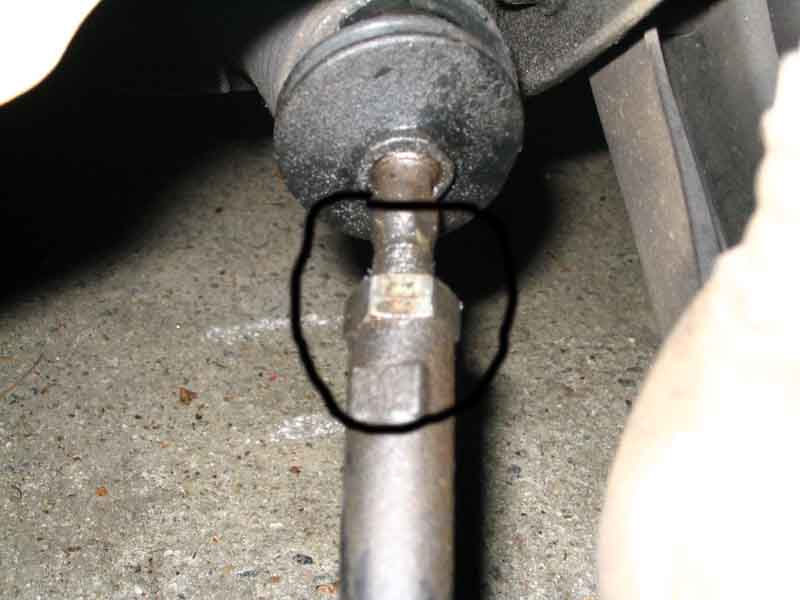

During the teardown, when i was "trying" to take the tie rods. it was hard has crap and i couldn't do it. i just wanna know if the nut a right turn nut or left turn nut. does anyone know? i mean i sprayed the crap out of it with grease the night before. I might try to heat it up with a tourch. Any advice would help.

Look close and see that the 'nut' is two parts!
The tie rod itself ends in a hex head, and then there is another nut on the end of that. The second nut is a lock nut that is tightened down onto the end of the tie rod. I believe both sides use standard type threading.
You will basically need two wrenches on there turned in opposite directions. It should come loose then.

They are standard type thread. Like Bleach said two wrenches will work. Put some *** behind it.
It'll come loose. There have been times where I've seen people having to use a heat or torch on the nut to get it free. But by looking at your pic...I don't think you'll have to go to that extreme. Good luck.
